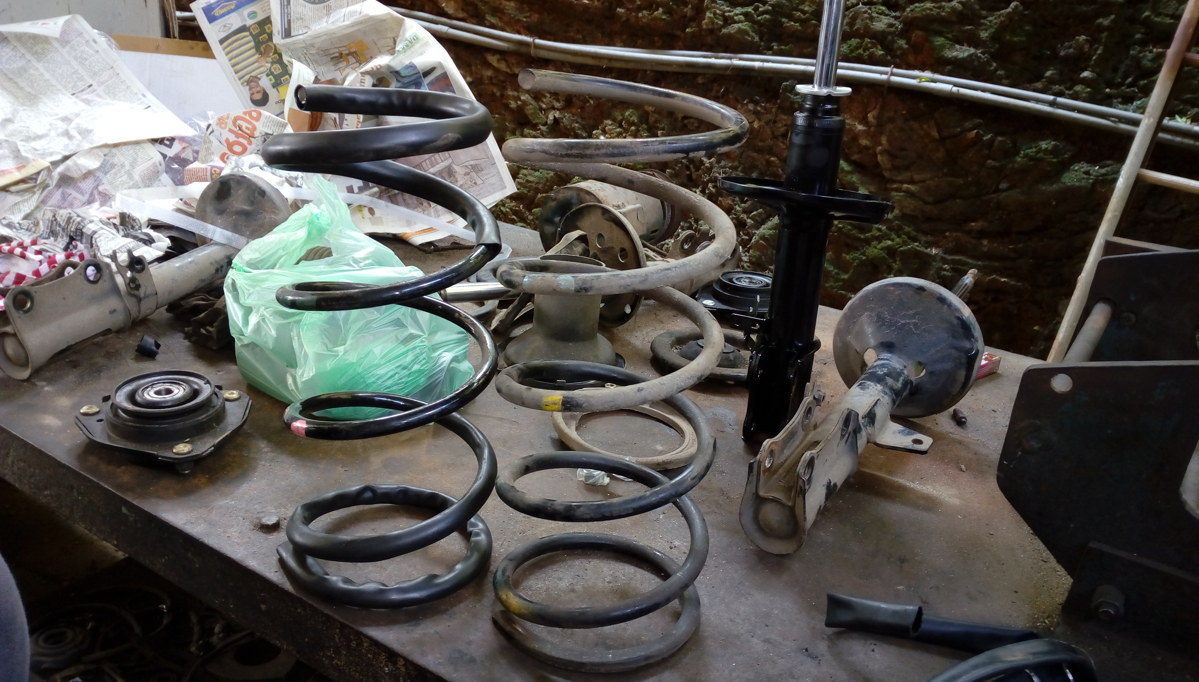

Carina AT 192 Coil Spring
Hi all, My Car front coils are of two different types. One has 5 turns another has 6 turns. I wonder what would be the original one came from toyota. Could you please tell me the original coil spring details or a photo, if anybody have toyota carina AT 192 ?
