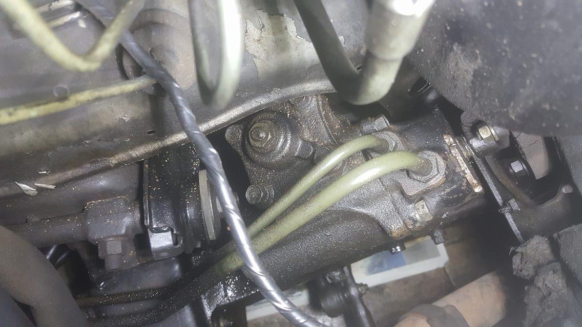

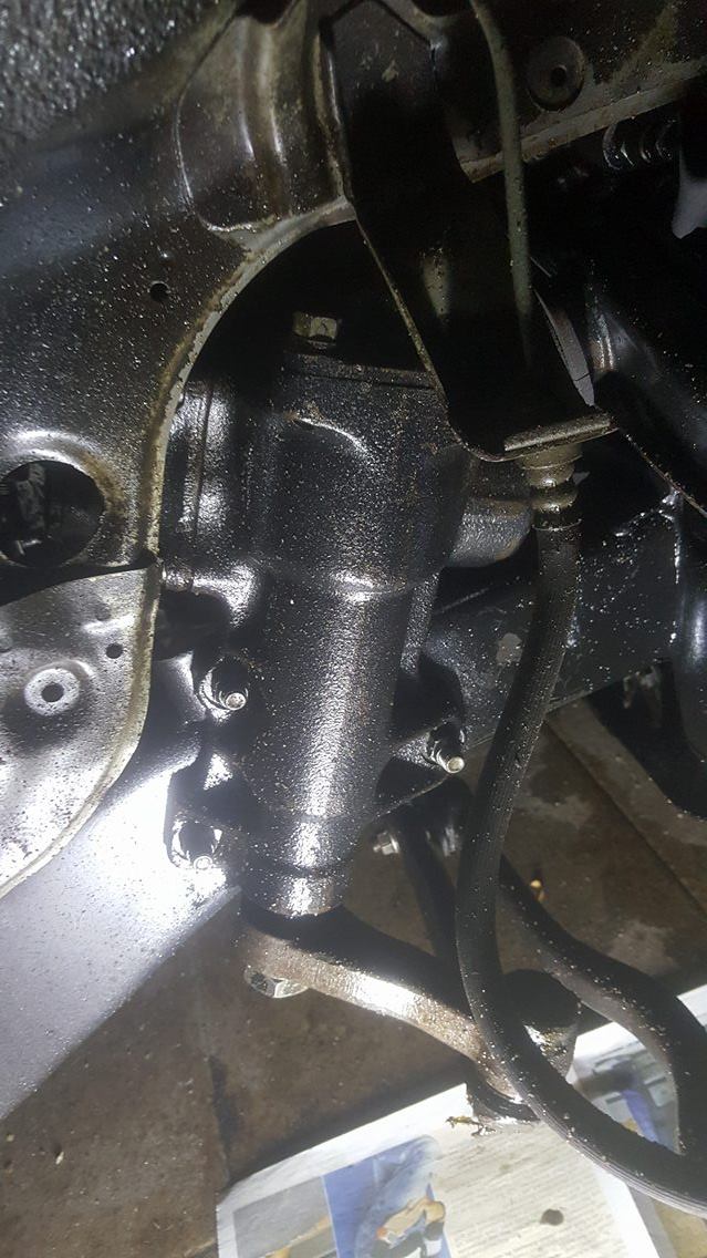

Today I went to a garage and replaced a rubber over-ring and a washer in the top part of the power steering box. Still no leak is visible. Also there were no damages according to the mechanic. There was a play in the steering. That seems to be also fixed due to the fix. Thanks you people for the instructions.

I have a 252-xxxx L200 2 wheel version. After the regular service which has done few two days ago, I hear a metal scratching noise when I turn the steering wheel. Today the sound got increased more and more and the steering got hard to turn. As soon as I came home, I checked the power steering pump. All the oil has gone. There is no leak in the pump horse lines. But in the power steering box, oil was all over the lower part. I put new oil and it took around 500ml to bring the oil level to max. I whipped out the oil on the box and chassis.Then I started the engine and turned the wheel many times.I cant see any new oil leak. But haven't driven after that. Is it OK to drive in this condition? what can be the reason for leak? Thanks! PS - These images are taken before whipping out the leaked oil.
