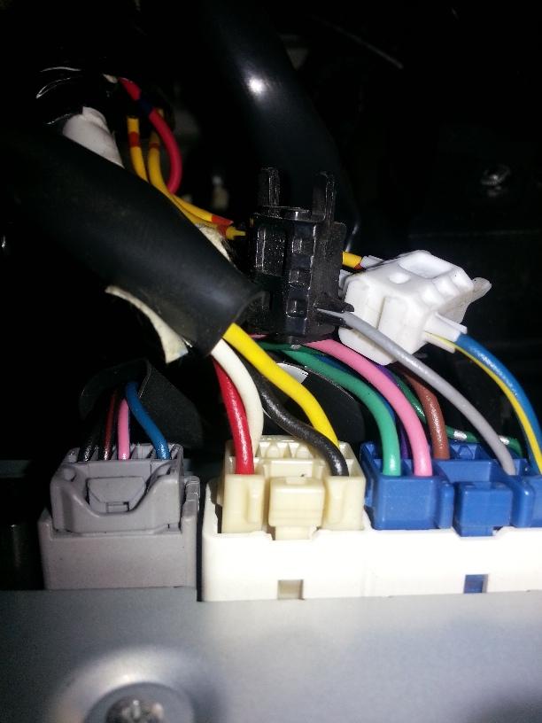

  1. took it to a audio shop. wire harness from front audio hub to rear hub was missing. Problem fixed... Thanks guyz...
  2. yes, but nothing works. there is no rear audio signal coming out of player.
  3. my kdh201 have came with rear audio wiring from factory. But theres no audio signal coming for rear speakers. wiring diagram and actual player rear i/o snaps are attached. i tried directly connecting speakers to the i/o panel, but still no audio coming out. is this a problem with my player. This is the original player came with van. Is there any settings to change.?? Thanks.
