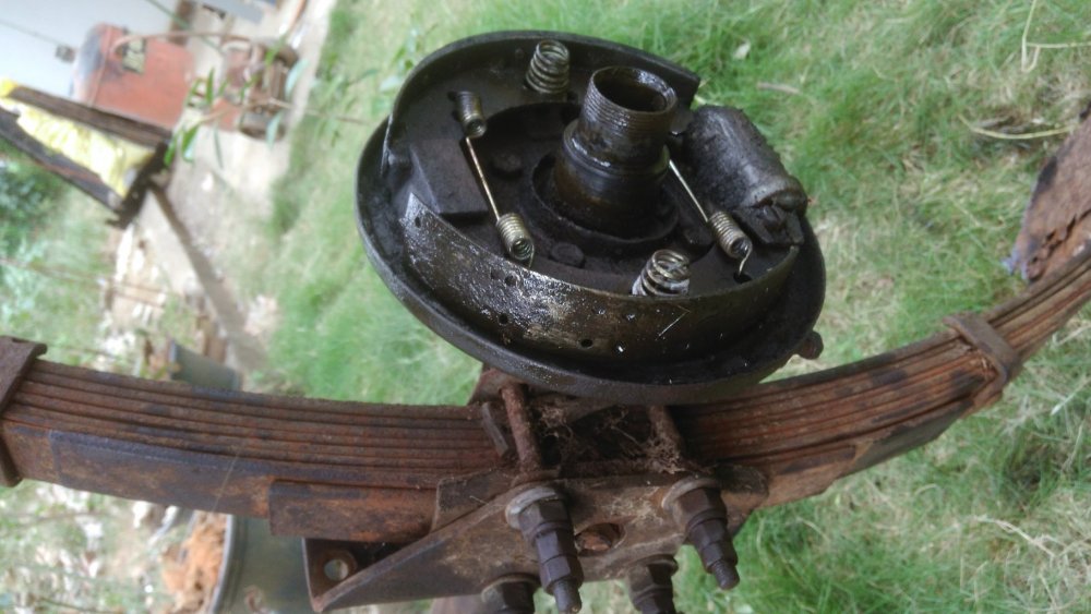

Weak break : As I mentioned in the previous blog entry, the brakes were very weak when the car bring to home. Had to press paddle 2-3 time to slow down the car. Could not exceed 30kmh. When started the disassembling work found that back oil seals leaked differential oil to the brake drums. Also one brake liner separated and was inside the brake drum. Now complete brake system disassembled, cleaned and repainted. What you guys think about the U bolts. Should I find new ones or threaded originals ? -

It seems finally you bought one.Congratulations !!!. Guess your cars brakes not modified. It is said that MMs brakes are weak by born. Mine also had very weak brakes when bring to home. Drove around 120km and had to press paddle 2-3 time to slow down the car. Could not exceed 30kmh and avoided all main cities. As I was aware cars condition, already planned rural roads. When I started disassembling it for restoration process found that back wheel oil seals leaked differential oil to the brake drums. See picture. Not sure you checked the drums yet. I suggest you to do the repairs in your home. As I have heard enough bad stories about restoring old cars in garages. Once they disassembled the parts/car the power goes to mechanic/garage owner. We need to obey what they say. Doing things in our home is other hand. Anytime we can change the mechanic. So think about it. Also try to find some old set of spanners which suit for old cars and try do things your self. Old cars are simple machines. There are many sites and fb groups for Morris minor cars which is very helpful. For tinker works too try to find a person who can visit to your place. Expend Rs 2000 - 3000 to bring his tools to your home. In my cars I am doing most things myself and still in the painting process. Willing to write a blog here soon.
