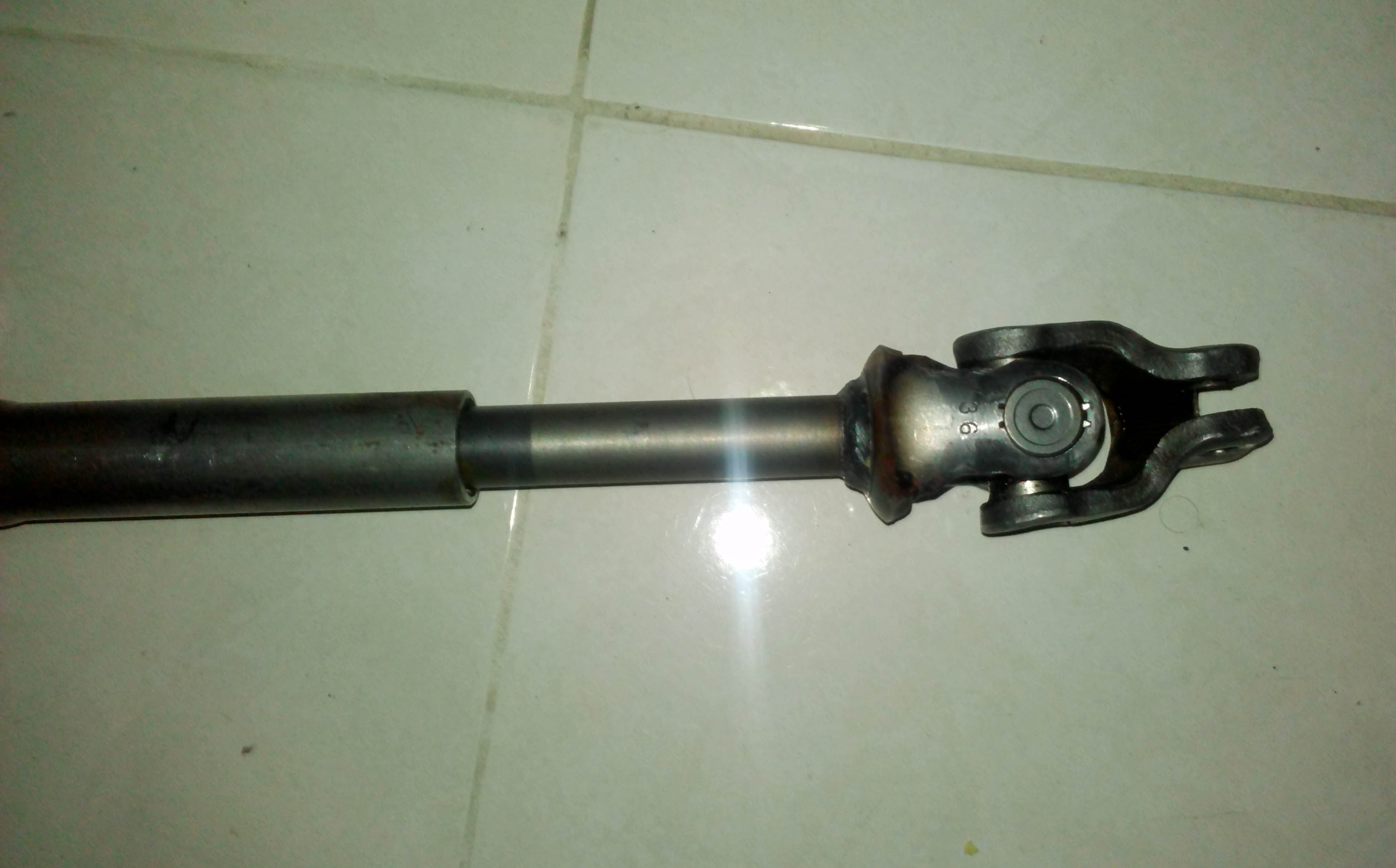

  5. I can't believe Suzuki still have this issue on their cars. From my experience on Suzuki Racks most of time fault is with steering column (Intermediate Shaft) see my previous post on this In this case as thirtyone's post it will also with steering column (Intermediate Shaft) my experience with 2003 Suzuki Cruze but on 2017 Swift?. It will definitely steering column (Intermediate Shaft). on the tie rack wears it self it can be replaced or repaired but it will not solve the noise you have to repair shaft also. in my case as above my previews post shaft replacing didn't solve the problem. few weeks later noise came back and i have repaired it again. I think this is their manufacturing fault.

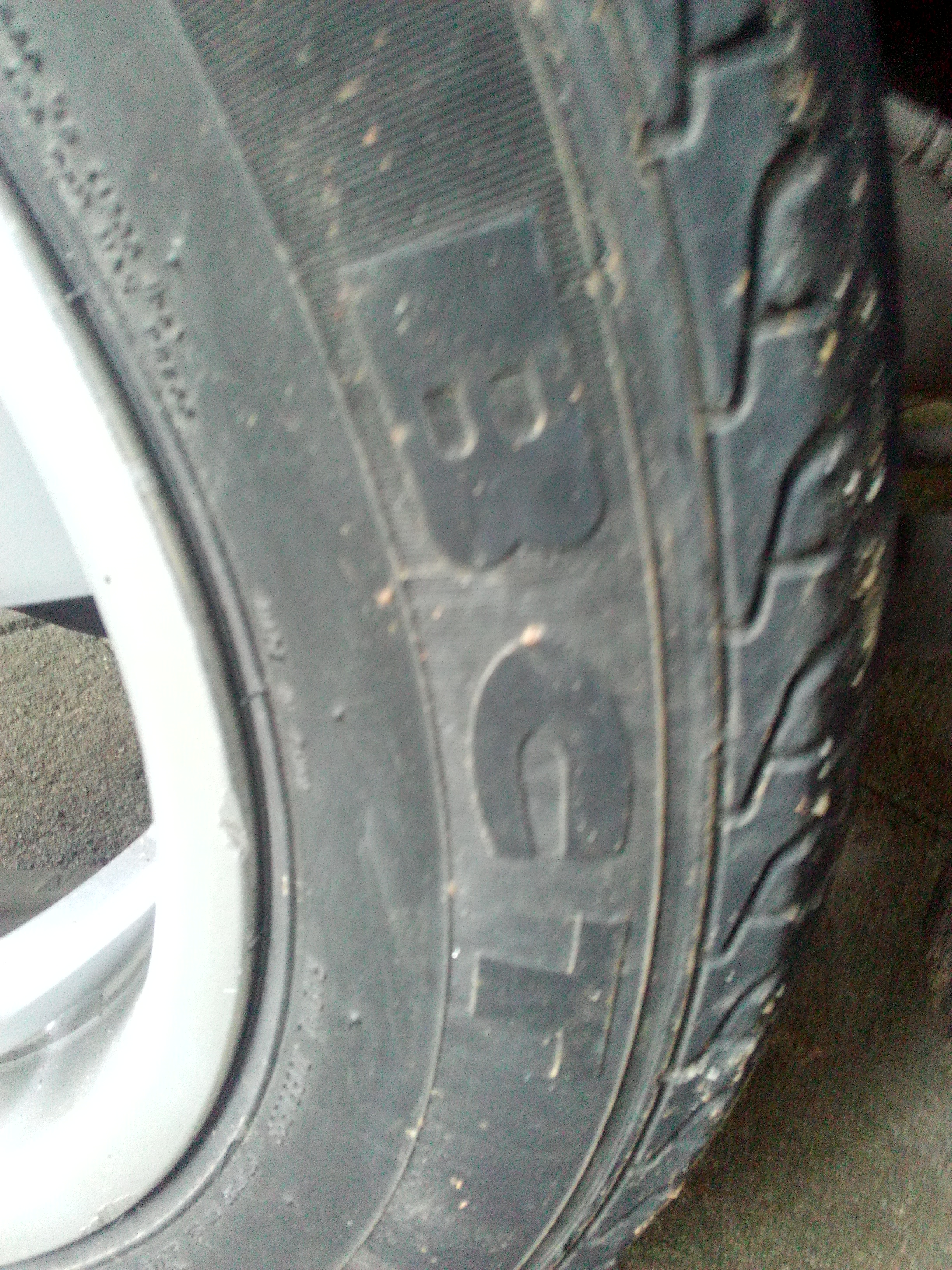

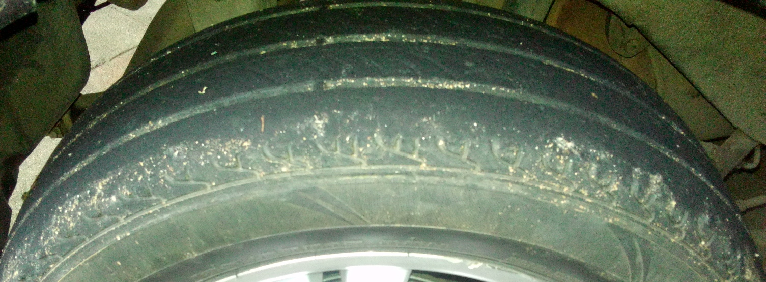

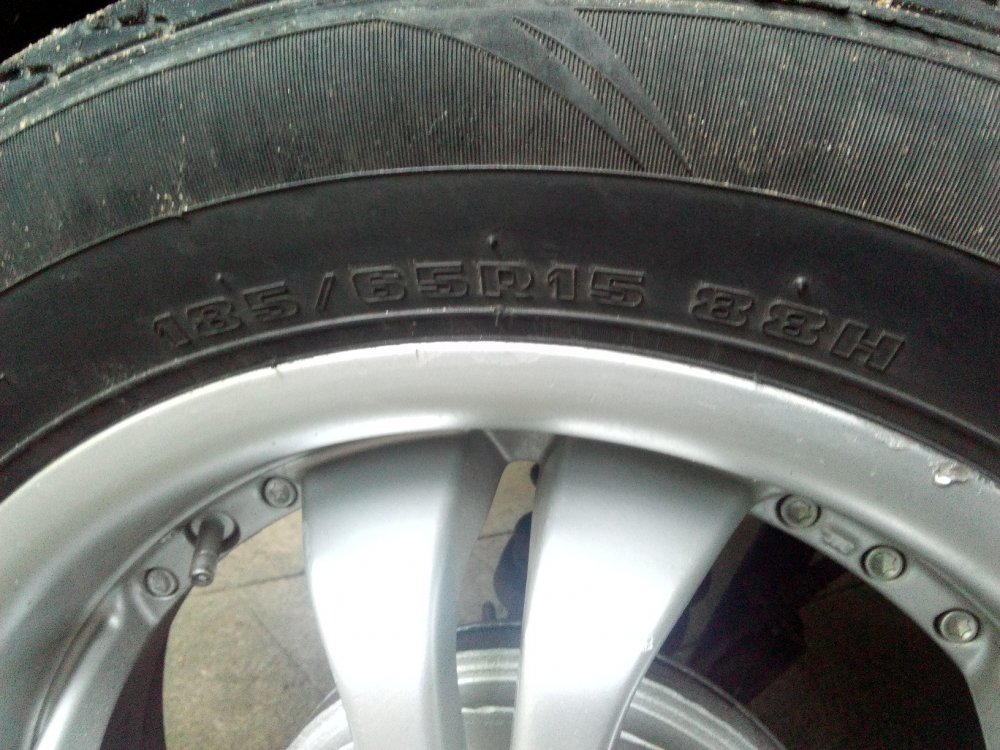

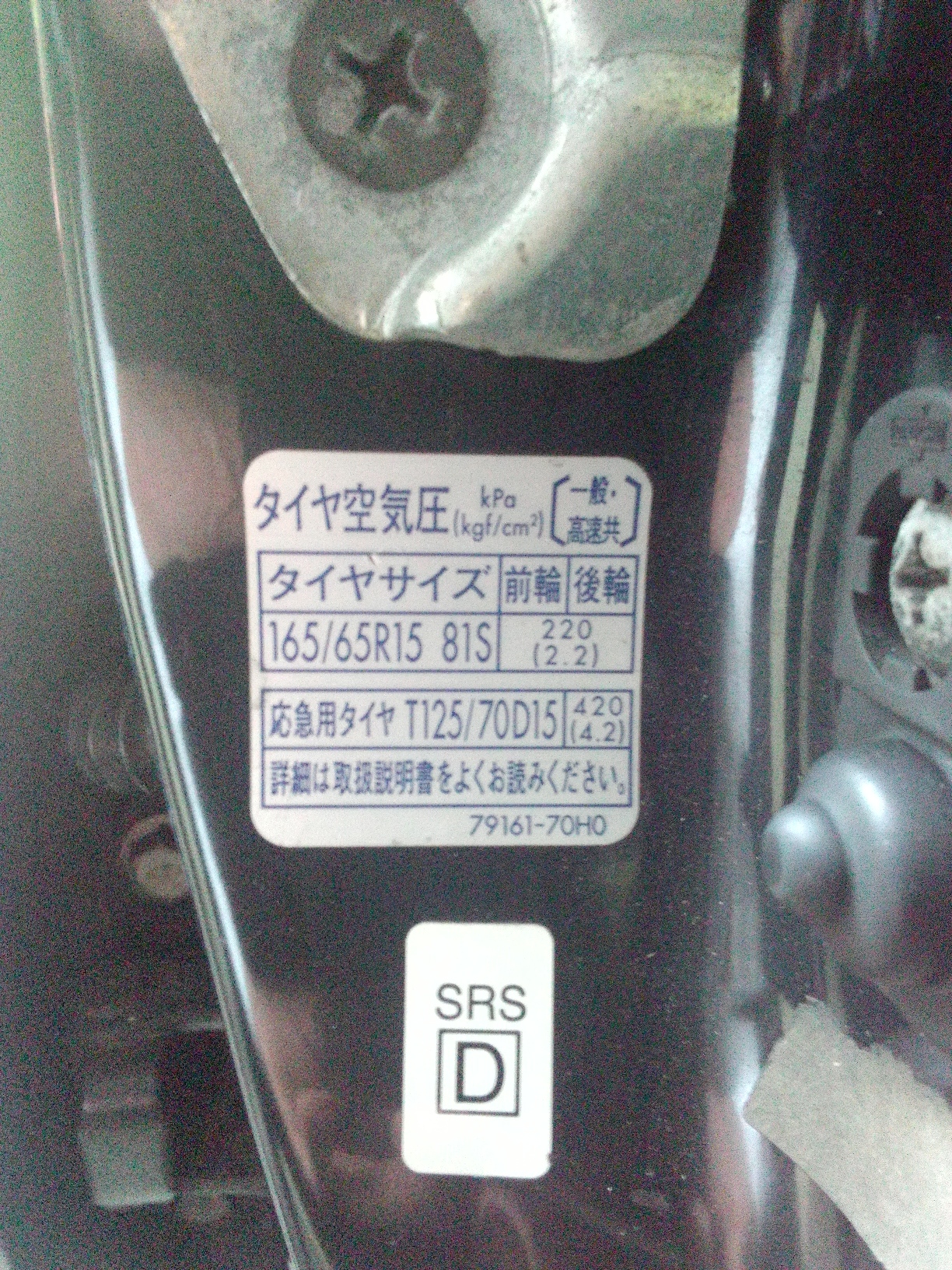

  20. Hi Experts I need some advice for my tires. I have read lots of threads related to this topic on the forum. But i need expert advice to replace my tires. When i brought my car one year ago it was fixed with brand new 4 tires. It was Chinese brand (BCT S600) and i knew previous owner fixed those just to sell the car. I am a daily runner average 40 km per day and now done 12000km. treads of the all 4 tires are totally gone and every time i visit to Tyre shops for check air or wheel alignment they says the tires are bad and rubber is very hard. But i know it can run further few thousand kilo meters. The my question is this is the reason for low riding comfort and high road noise i am experiencing form my car? The recommended Tyre size is 165/65/R15 but existing size is 185/65/R15 is this also a reason? Can i get noticeable difference if i replace the tires with good brand and correct size. also previous owner has replaced the original alloy wheels with Chinese brand ( I don't know why hell he was done it) is that make trouble when put correct Tyre size? Is this Chinese BCT S600 is actually bad brand? what are the good quality tire brands for my car. Car is Chevrolet Cruze. Advises are highly appreciated.

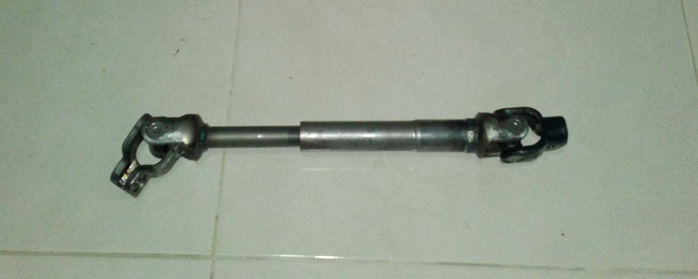

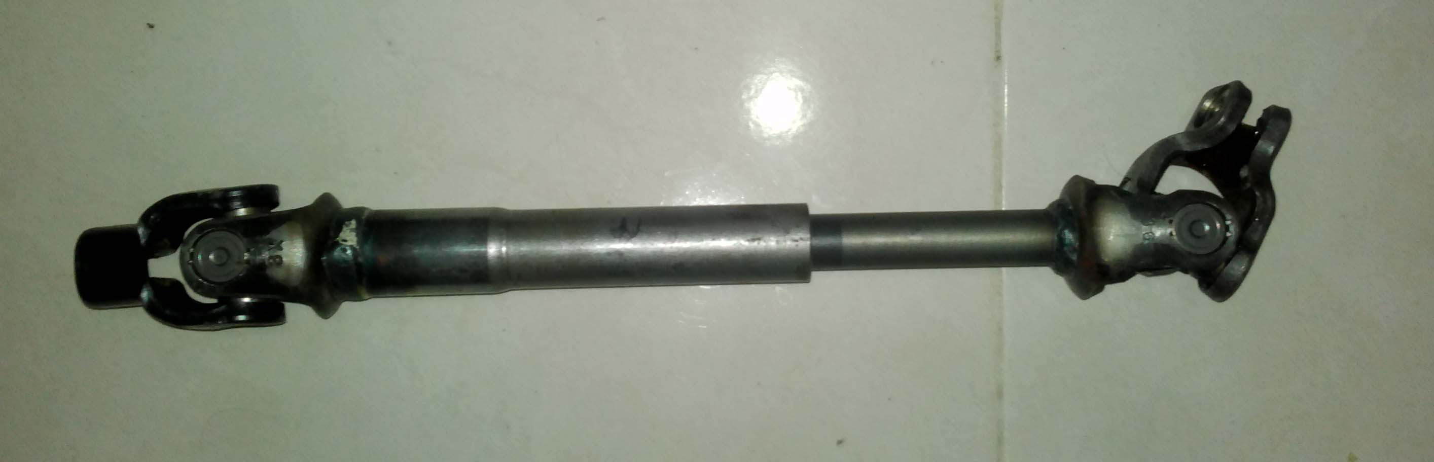

  21. This is old topic and i thought to share my present experience (also reply to asanka_rg) Do you still have steering rack noise on Chevrolet Cruze? I am happy to say I have resolved my steering rack daka daka noise last week. The issue was not with steering rack whole time it was with Steering shaft which inter connect rack to steering wheel. There is small play with steering shaft couplers and very noticeable loose with shaft joint (The joint which use for adjust the shaft). Problem found out by myself as this has been big headache to me as I have already replaced the whole steering rack few months back. To find the issue I drove cruze on potholes with my left foot tight to the steering shaft under the dash board and noise disappeared. Straight away went to the mechanic and replace the shaft. Very easy replacement just has to remove two bolts (shaft upper and lower) under dash board. Few used shafts found easily (removed from Suzuki swift steering column as they are same). I am pretty sure this steering shaft Play/rattle is a common issue on Suzuki swift and Cruze because I have replaced shaft twice. First one replaced also has play. Second one is OK. Another thing Chevrolet Cruze steering rack 100% identical with Suzuki Swift HT51 Model. every used parts shops mislead me except one place which I bought shaft. I have compared my old steering rack with swift rack they are same. When searching web for this issue I found following about steering shaft. http://www.ttora.com/forum/2-early-tacoma-tech/161689-diagnose-fix-steering-play-rattle.html They are suggesting put welding dot for shaft and repair but my mechanic says it will be risky for ECU and the electronic component and if you want to remove steering column first have to remove entire steering rack. Happy to say now my cruze not have any kind of noise from rack. I have attached few photos from my old shaft
