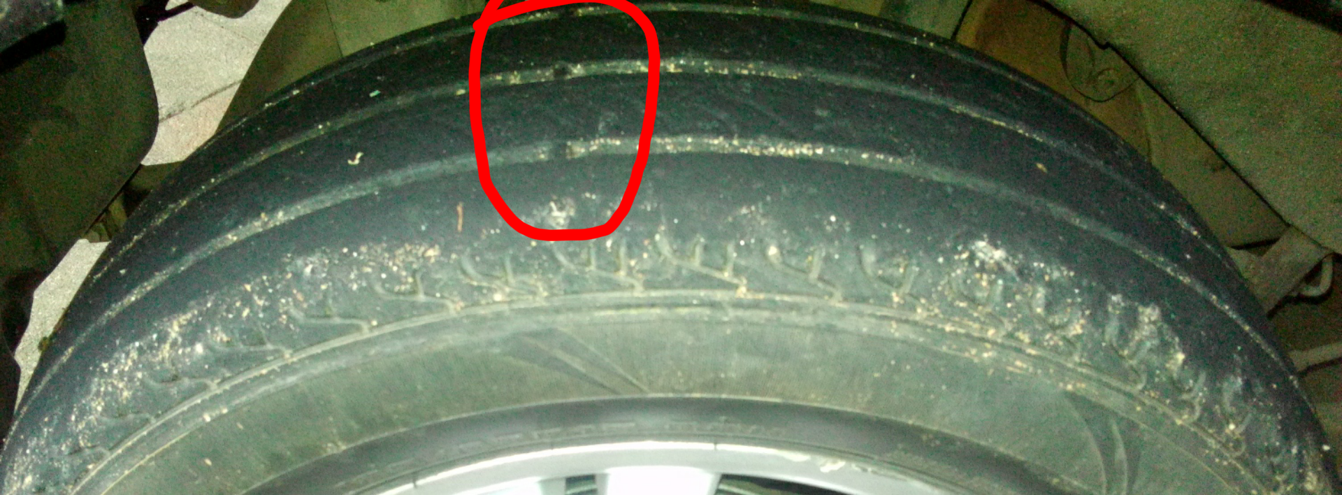

When i brought my car one year ago it was fixed with brand new 4 tires. It was Chinese brand (BCT S600) and i knew previous owner fixed those just to sell the car. I am a daily runner average 40 km per day and now done 12000km. treads of the all 4 tires are totally gone and every time i visit to Tyre shops for check air or wheel alignment they says  the tires are bad and rubber is very hard.  But i know it can run further few thousand kilo meters.

First of all the vertical lines in the marked area are called tread wear indicators,  if this and the rest of your tires tread are on the same level then it's time to change tires.
Secondly your tires outer edge has not worn evenly indicating some issue with alignment or suspension .

More than comfort, Safety is lost in our rain soaked roads.
Having seen the tread depth of the tyre, it's high time you replace them asv they have worn to the wear indicators.
