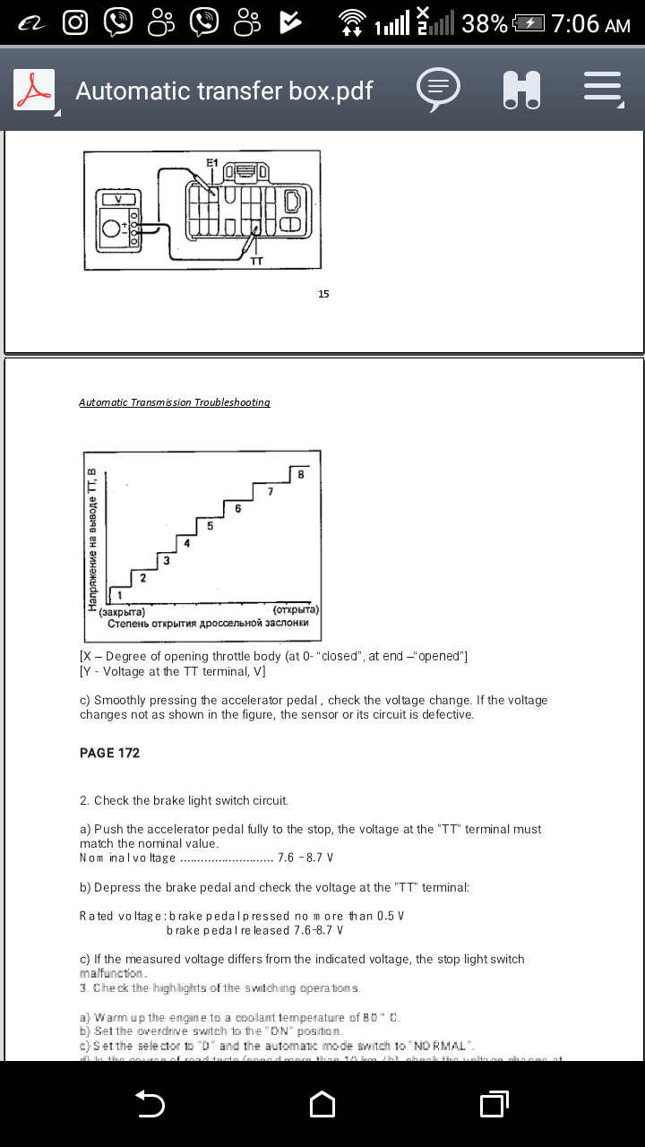

Transmission test
Dear All, Recently I followed a test in my car manual on transmission test. Test is in figure 1 and this test is done ignition on. I did this and smooth increase in voltage betweeb TT and E1 happens. But the problem is maximum voltage is 4.7V. This graph shows 8v. Is this a malfunction on my TPS? I checked TPS it gives vlaues within the range mentioned in manual but in the lower margin. However within the range. Could you please advise me on this? Does this imply my TPS is in poor performance? Do i need to replace it? Or ADJUST it? thank you all..
