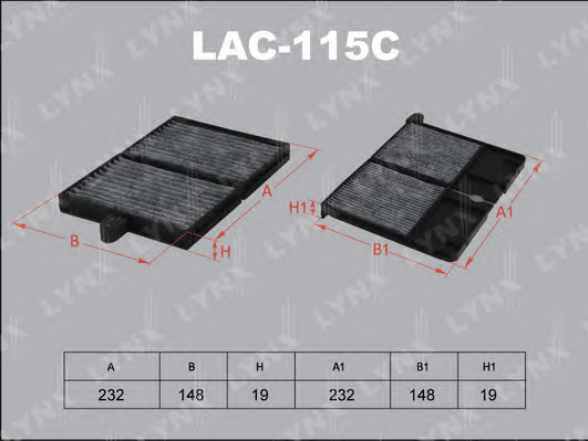

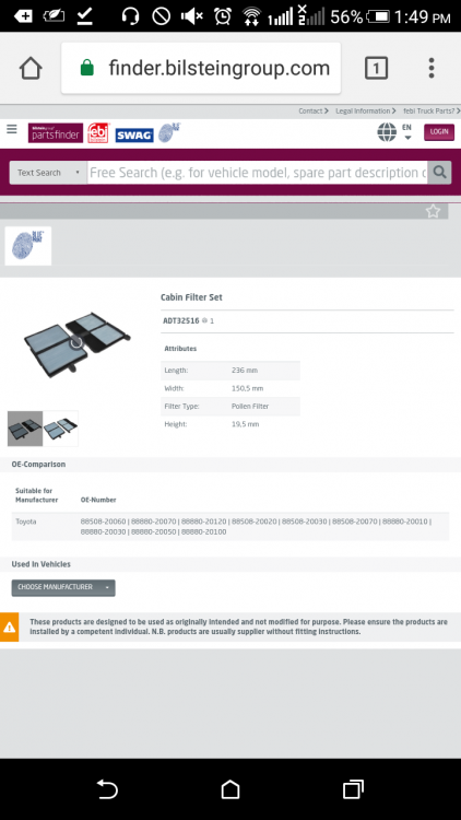

I was totally dissapointed to hear almost all the so called "AC repairers" do not know that there is a cabin filter in toyota cars like corolla, carina and corona in 90s. My car is 96 one which is not having a filter in the compartment and i am searching this filter. Still I was unable to find in panchikawatta and several other places. In internet this item is available. Anyone who knows local place to get it? At least to order ?
Toyota PN : 88508-20020 ( upper filter)
88508-20030( lower filter)
Sakura eqvlnt: CA11070
