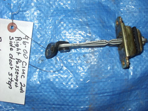

Hi Can any body tell me what kind of grease should applied for door detent rood(see attached). in side this unit got Teflon cage, metal roller and rubber blocks. normal grease not suitable for Teflon as i got information from mechanical engineer. because i have applied normal grease and door is very noisy when I open the door it is hard than before. Sira the topic should corect as Door detent rod- Engine Capacity Vs Fuel Consumption
