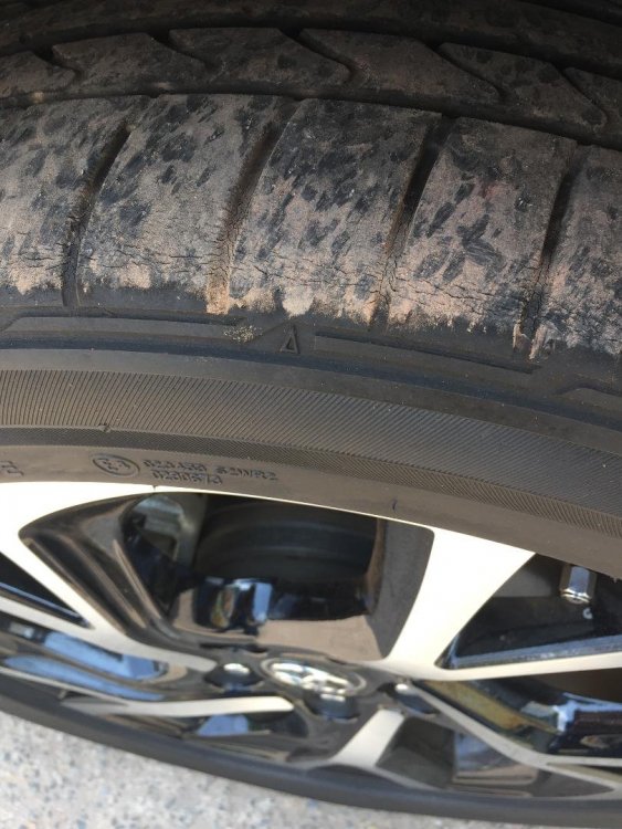

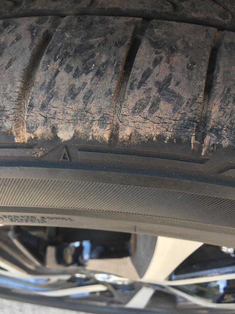

Thanks @iRage for explanations. Regarding tyre cracks - Those are not visible until you peep near the tyre and carefully observed. Yes they are slightly above the tyre walls - the angeled/ curved edge between the tyre wall and the outside Tyre surface. That area not touching the ground. But those crack like things are merely visible (tiny/ hairline like). I thought it’s due to the tyre is getting old (almost 3 years). (I saw this while when I try to determine the tyre wear out in order to guess the true mileage in case of odometer tampering. Tyre wear out ratio seems to be ok when I compare with my previous car’s tyres. Those also Bridgestone tyres and those were there for around 4 years with 40,000+ km riding. But didn’t experienced that tiny crack like things - may be I did not observe.)- 33 replies

Update: I got the manual verification report from https://jpcenter.ru/ It's tally with the auction sheet given and seems there are no issues except a minor scratch in the body. Car's photos are ok. There is a small comment on comments section, when translate it Google translator shows it as "body kiss", don't know what is that ☺️ (attached that image for just reference marked with red squares). While inspecting the car no doubts were there except, - Bridgstone tyre edges had little hairline fractures like tiny cracks (can be ignored). The sale guy said those are due to the temperature difference in Japan's winter season and here while idle for few weeks - All 4 wheels are alloy wheels and I noticed little bit of dust like rusts on the inner area of alloy wheels. He said that also normal. (I have noticed in this my previous car too, when it idles for few days this little rusty dust is coming and once washed they go away). Hope this also normal.- 33 replies
