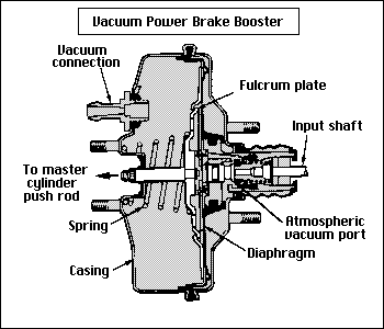

I had a same kind of noise prob in my FB15 long time back - Changed the Brake Saver/Booster.
http://www.aa1car.co...ary/booster.gif
Check your saver rubber seals where the arm rod/shaft goes in.
