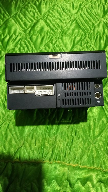

Is there a way you can change FM radio components with 75 to 90 and replace with components with 88 to 108?
