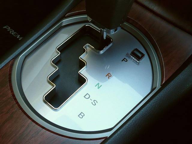

CVT in a 2008 model Toyota Premio
post-47484-018444600 1298650160_thumb.jp
the D is for normal driving....just like the you get in a A/T...while the S stands for "sport" it is for powerful mode...and B is like the "L" in A/T
hope this helps you :)

how to identify a CVT: well theres a difference in the gears in the CVT, CVT comes only with "P,R,N,D,S,B" this could vary from vehicle to vehicle
I keep telling you, know your stuff. Sport isn't a "Powerful" mode, it just delays shifting gears so you can keep the engine in a higher rev band.
