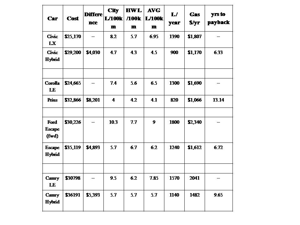

From my research, this is the information that I dug up. Below is a table comparing some popular hybrids with their gasoline counterparts. The table calculates how long it would take the gas savings of a hybrid to pay for the difference in purchase price from their gasoline sibling.
Some notes about the data:
The costs are the purchase price after taxes/levies/fees and with the ecoRebate applied if applicable.
The comparison does not account for the extra maintenance cost (or depreciation) of the hybrids.
Assumes the gasoline price of $1.30/L or around $4.91/gallon.
The comparison is based on financial differences only and does not evaluate the green benefits.
It seems that the best value out of the bunch is the Honda Civic Hybrid which would take over 6 years for the gas savings to make up for the difference in cost. Even though the Prius claims the best fuel mileage, its the worst value of the bunch. The Prius would take over 13 years to pay for its premium, thats 13 years too long for me. With all the extra electronics involved with a Hybrid, its also bound to have extra maintenance costs also, which is not accounted for.
Out of the vehicles compared, the price premium attached to the hybrid vehicles are just too great to be considered a cost savings relative to purchasing their gasoline counterpart. In order for me to even consider a Hybrid, their prices would have to come down to the level of their gasoline competition.
not my research.. source: http://www.milliondollarjourney.com/hybrid-vs-gasoline-vehicle-comparison-are-hybrids-worth-it.htm
