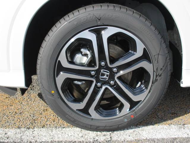

0 B2Spirit Posted October 8, 2014 Author Posted October 8, 2014 (edited) has anyone seen how the tire on Vezel Z Hybrid sits on the Rim ? Rim is kind of nestled in within the tire. Is that a new tire design ? http://picture1.goo-net.com/061/0610001/J/0610001A30141006W00108.jpg Edited October 8, 2014 by B2Spirit Quote
0 The Don Posted October 8, 2014 Posted October 8, 2014 has anyone seen how the tire on Vezel Z Hybrid sits on the Rim ?Rim is kind of nestled in within the tire. Is that a new tire design ? http://picture1.goo-net.com/061/0610001/J/0610001A30141006W00108.jpg The overhang is designed to protect the rim from kerbing. Different tyre brands give different names to the feature. Quote
