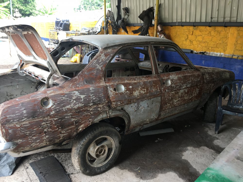

I am doing up a 4 door 1971 Escort Mk1. 4 door as I have 2 young kids. No expenses spared. Every thing bog standard with no bubble arches or anything. Only extras would be Air Conditioning and some mean wheels.
I am struggling to find some nice old school 4x108 wheels in Sri Lanka. Can anyone direct me to any place?
My first option for wheels would be 15inchx6wide with low profiles.
Car came with 13x5.5 ET+19
Any thoughts on paint? I was thinking of pearl/candy sapphire blue.
