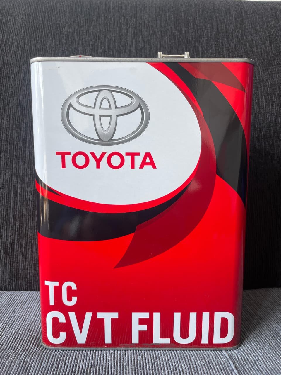

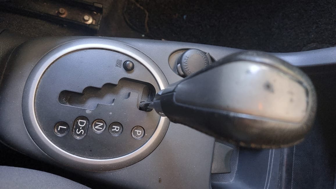

This is what I have. So Toyota TC CVT fluid Ok, right? WhatsAppImage2025-08-18at19_24.08_a6b181bd.thumb.jpg.78f1412bedaebe7e582a771cb3727022.jpgWhatsAppImage2025-08-19at09_39.20_bba48fd1.thumb.jpg.3fa68f6812902e51d50315a5449deadc.jpg
You are going to have to double check it through your chassis number (I am not sure if Suzuki ID plates have the transmission on them).
By looking at the picture that looks like a CVT. The Automatic has P, R, N, D-3, L while the CVT had D-S instead of the D-3.
Again...YOU SHOULD DOUBLE CHECK ! If you are uncertain about how to do it, you should give it to a reputable garage to take care of the entire process (i.e. buy the proper oil and do the change along with replace any seals, filters, etc..).
As for the oil itself, you need to make sure you get the CVT fluid that meets the manufacturer's specifications. The owner's manual says Suzuki CVT F-Green 2. I don't know what the spec of that oil is. A quick internet search should tell you what other brands and types meet this spec.
