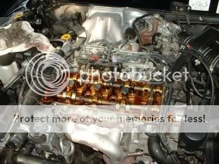

Guys,,
This post is related to the first post of this thread.
Yesterday I got a fully machanical check up of my car (toyota lanka, kurunegala). We opened the tappet cover also. There is a brownish stain in side also, but the technical manager told me it is not sludge. he also told me that I dont need to worry and he didnt see any use of cleaning the whole engine. Also, they often see these kind of cases.
He also showed me some photos of really sludge formed engine.
Guys, toyota lanka recommends 10000 km oil change intervals for semi-synthetic oil!!!!!. why is that. Yesterday, i saw even owners of new yaris cars (permit), stick to this recommendation. What is your openion on this.....

Guys,
I am the person (vitz) who initiated this tread. However, I could not recover my account anymore.
While thanking for all, who replied for my post, just thought of sharing my own experience.
After purchase, I have driven my vios 43000 kms without any engine trouble. No complaints about fuel consumption. I only did timely servieces (5000 km intervel), used Toyota oil+Filter. Thats all.
Let me conclude that the minor deposition of brown colored materials in the surrounding area "interior" of oil cap, doesnot indicate a severe sludge build up
Toyota did few mistakes around 1998-2003. first, they made the engine run little hotter to meet the emission requirements. second, they made the oil passages smaller . To keep it simple IF THE VEHICLE IS MAINTAINED ACCORDING TO THE TOYOTAS RECOMENDED INTERVALS you will never have a sludge issue. always change your oil on time with good quality oil. Using engine flushes will clean the engine but its not the best stuff for your rubber seals and gaskets. Change your PCV valve every year.
my dads van thats not maintained well by the previous owner
picture below is my car with the same engine that's always been maintained every 5k miles with good quality oil
