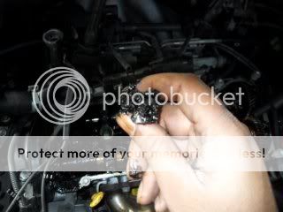

picture above is my Dads van. it was sludged up so bad not even a flush couldn't remove all the sludge. so i removed both valve covers, removed the pan, scooped all the sludge out, got a brush and start washing out with a Heavy duty parts cleaning chemical. cleaned the oil pan/ pick up screen, put everything back
together with new gaskets and seals.
