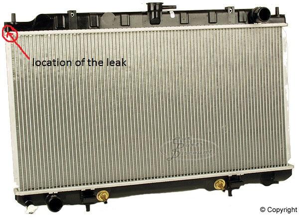

NRX Posted March 21, 2013 Posted March 21, 2013 (edited) Guys, I noticed a coolant leak of my car recently after a drive. When I checked for the location I could see that small coolant drops form near the area where the aluminium core and the plastic top tank connects. There isn't any crack but the leak happens from the edge of the area where the plastic and aluminum core connects. What are the options to rectify this ? This happens only when the engine is hot BTW. Please find the attached image of the location of the leak. Edited March 21, 2013 by NRX Quote

The Don Posted March 21, 2013 Posted March 21, 2013 Guys, I noticed a coolant leak of my car recently after a drive. When I checked for the location I could see that small coolant drops form near the area where the aluminium core and the plastic top tank connects. There isn't any crack but the leak happens from the edge of the area where the plastic and aluminum core connects. What are the options to rectify this ? This happens only when the engine is hot BTW.Please find the attached image of the location of the leak. nissan_sentra_2001_radiator_oem_21460_6m200_214606m200.jpg If the top tank hasn't cracked, you can usually stick it back on usually thermo resistant glue. This is what they do when they manually clean radiators anyway. Just take your car to a radiator repair place and they will sort you out. Quote
