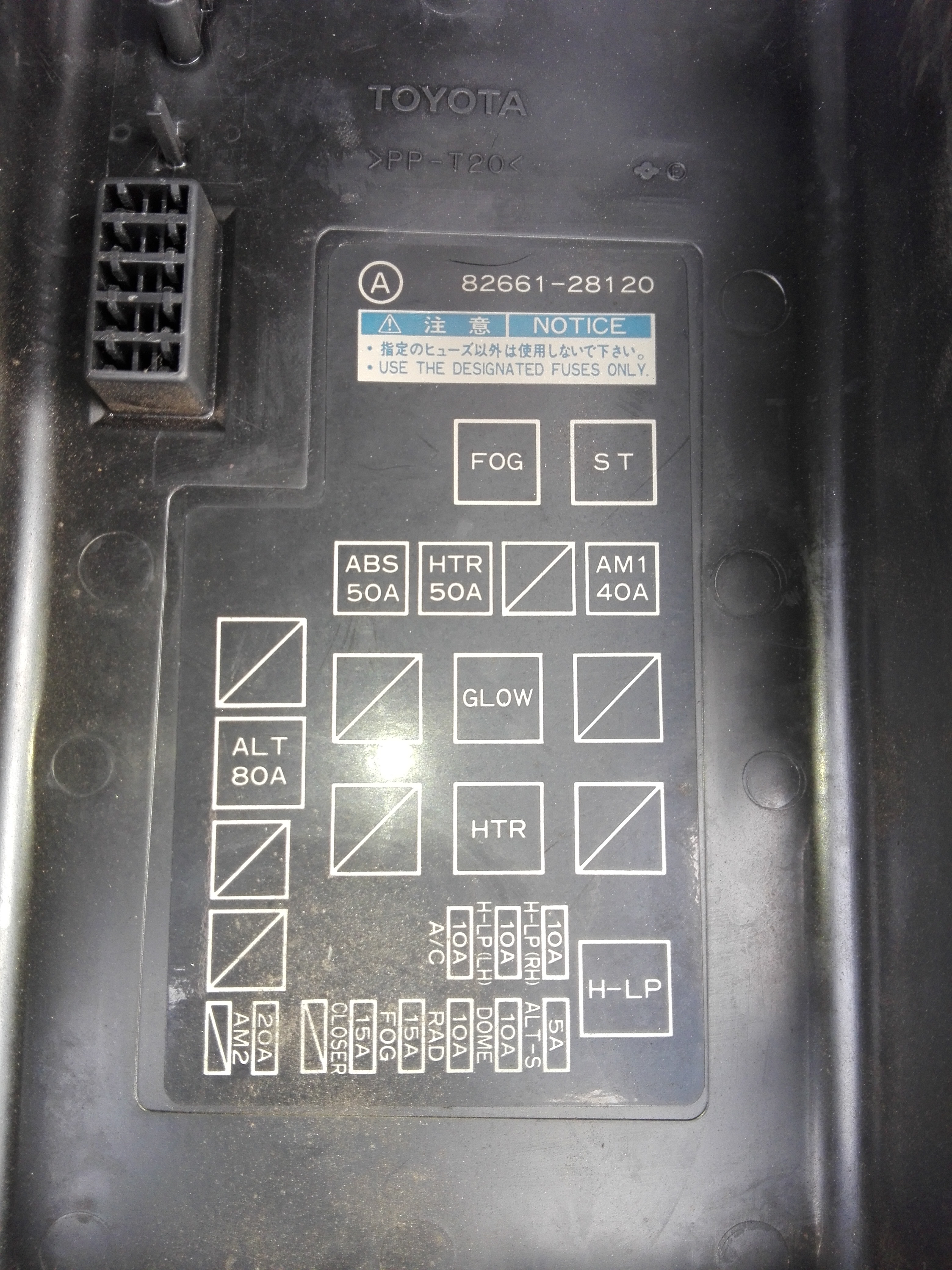

  • Author
14 hours ago, iRage said:
No idea....I haven't had a 4WD TownAce/LiteAce. Depending on the type of system Toyota had it may or may not have fuses (as it doesn't need it) or an indicator light for that matter.
I attached the relay box, my one is CR51 liteace, please kindly consider and let me know about the system
There isn't a specifically marked fuse there...but since this is a mainly mechanical system it wouldn't need a fuse. Like I said before...this was a grey time period for Toyota AWD systems and dependingon the exact system that the car has it may not have any indicator lights (for example my JDM 1st Gen A/T RAV4 didn't have a AWD light in the cluster but the M/T variants had a light to indicate the center diff lock on and off. So.. perhaps the TownAce/LiteAce had the mechanical system still ? I think Tiv's reply suggests it did have a mechanical system.
