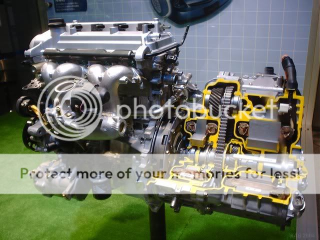

14 minutes ago, trish_auto said:
This is for clarification. Isn't Prius and Aqua using the same transmission system ? CVT ?
Both Prius and Aqua use Toyota PSD transmission. It is not a conventional CVT (based on a belt and two conical pulleys) but what they call as a eCVT.  It is just a set of planetary gears but under electronic control.
  • 0
Thank you.  Actually what Toyota models  actually using conventional CVT ?
https://priuschat.com/proxy.php?image=http%3A%2F%2Fi653.photobucket.com%2Falbums%2Fuu256%2Fjayman_photo%2FPrius%20Stuff%2FPriusHSDassembledtomotor.jpg&hash=f6ea7d0f4844b9ef7901a51d5903b792
