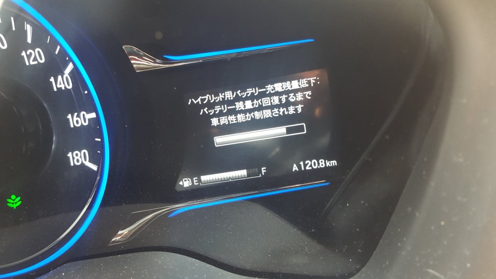

Does anyone knows what this means? Tried the google translate app but not very clear.
Picture taken from my Honda Vezel. Every time I drive in traffic congested areas (happens mostly during the day), suddenly the air con stops working (blows warm air) and engine knocks, gear shifting delay and then this (above attached photo) comes up on the display. Once this loads fully everything gets back to normal, but I haven't seen any other warning lights come on. Anyone had similar experience or does anyone know what this means?
Basic translation =
Hybrid battery charging reduced/low:
Until battery charging/level is normal vehicle will have limited functionality.

wait for sometimes let the baterry recharge and you get ready to drive on the dash borad and satrt again it will be normal
or you can have vezel scan and learn gear box setting
Better to get this scanned before (recommend the agents) when you identify the problem you can decide where to do the repair.
This could be due to your normal 12V battery get it checked first, can do at any battery shop.
