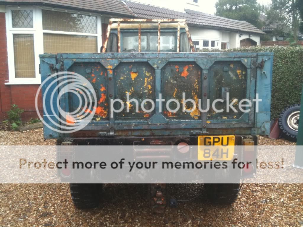

after seeing Lakshanks rebuild it gave me the enthusiasm to do my own! Here are some pictures of me recovering it and taking home!
After a good wash!
All in all its a very solid vehicle with minor chassis repairs to undertake and some TLC will see it right!

One hell of a project you got going on there. Are those rollers for a rear winch on the back bumper? What sort of a restorations do you have mapped in your head?
Also couldn't but help notice the 110. Any reasons as to why the third row windows are protected?
LakshanK would be able to give some golden insight with regards to the forward control.
hi there, nice landy!
She's in good shape.. and quite original.. I guess this is gonna be one interesting project..
What are your plans for her? Whats under the hood?

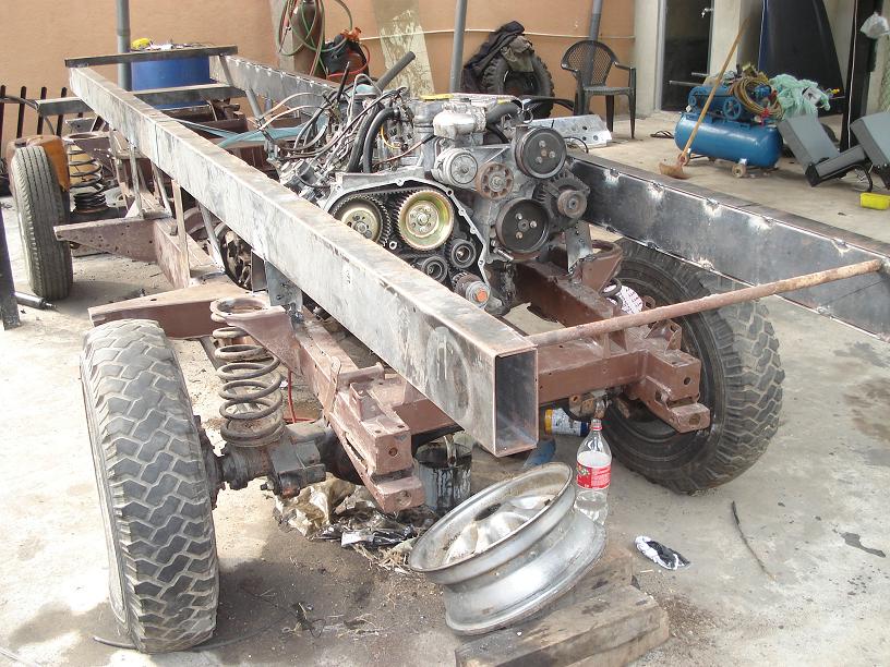

No it wont work. The intercooler lines are designed in such a way to work at its optimal with that factory made length for the 300 tdi. If you increase the length of the sucssion line( i am pretty sure its the sucssion that matters most) the turbo performance will all be gone. I had Nicely done aluminium pipes like you said. But when I went on for a trial it was slow and smoky as hell. I first thought it was some problem with the engine. Then I tried every single thing I could ever think of. Engine was tested for compression and it was bloody good. Then checked the turbo and it was ok. One of my uncles who worked as an aircraft engineer told me the physics behind the intercooler lines. I then completely remved the intercooler and went on for a test drive. It was much faster than before. I then realised where the error was. I remevd the intercooler from the rad and mounted it near the engine to a side and powered her up with an electric fan. Unbelievable..I was then experiencing the strength of the 300Tdi.
As with the steering mechanism, We cant straight away use the defender parts. With defender, the steering column goes straight into the box and then into the diffs.
But With FC, the diffs are sitting behind the steering. We have to make use of some links. Thats why I used a Toyota adjustable column and a box. Then If you look at the attached picture I have used another part from a mitsubishi 4DR5 jeep. I am not sure what you call this part. Is this the drop arm link.??
This was the key part I think. Land rover parts are not easily available in Sri Lanka and they are really expensive, Thats why I had to come come up with japanese solutions. Also Sri lankan mechanics are more comfortable with japanese vehicles and parts. However I am sure you can come up with a better solution that mine, after seeing all this. Mine was a guinea pig and there were a nuumber of drawbacks.
Hope I can help you to rectify those.
hope this helps.
any questions please ask. We are here to help. cheers comrade !!!
