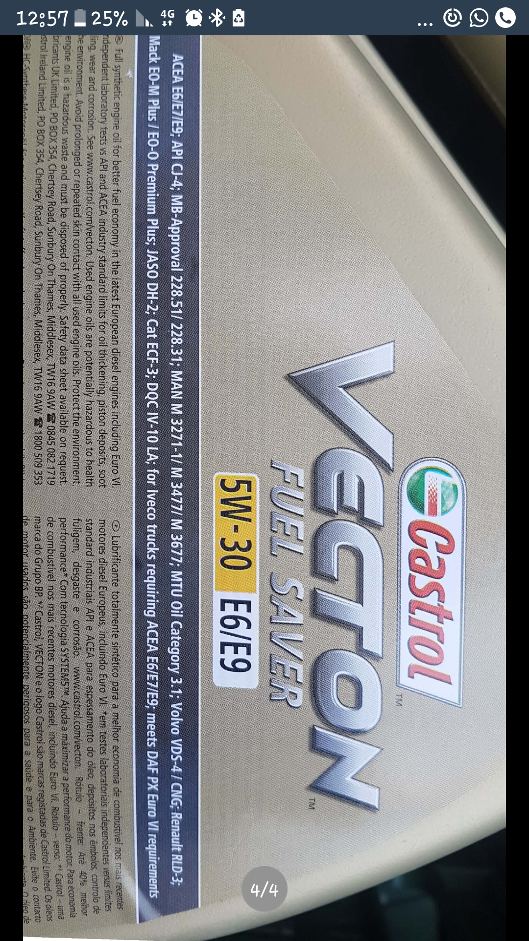

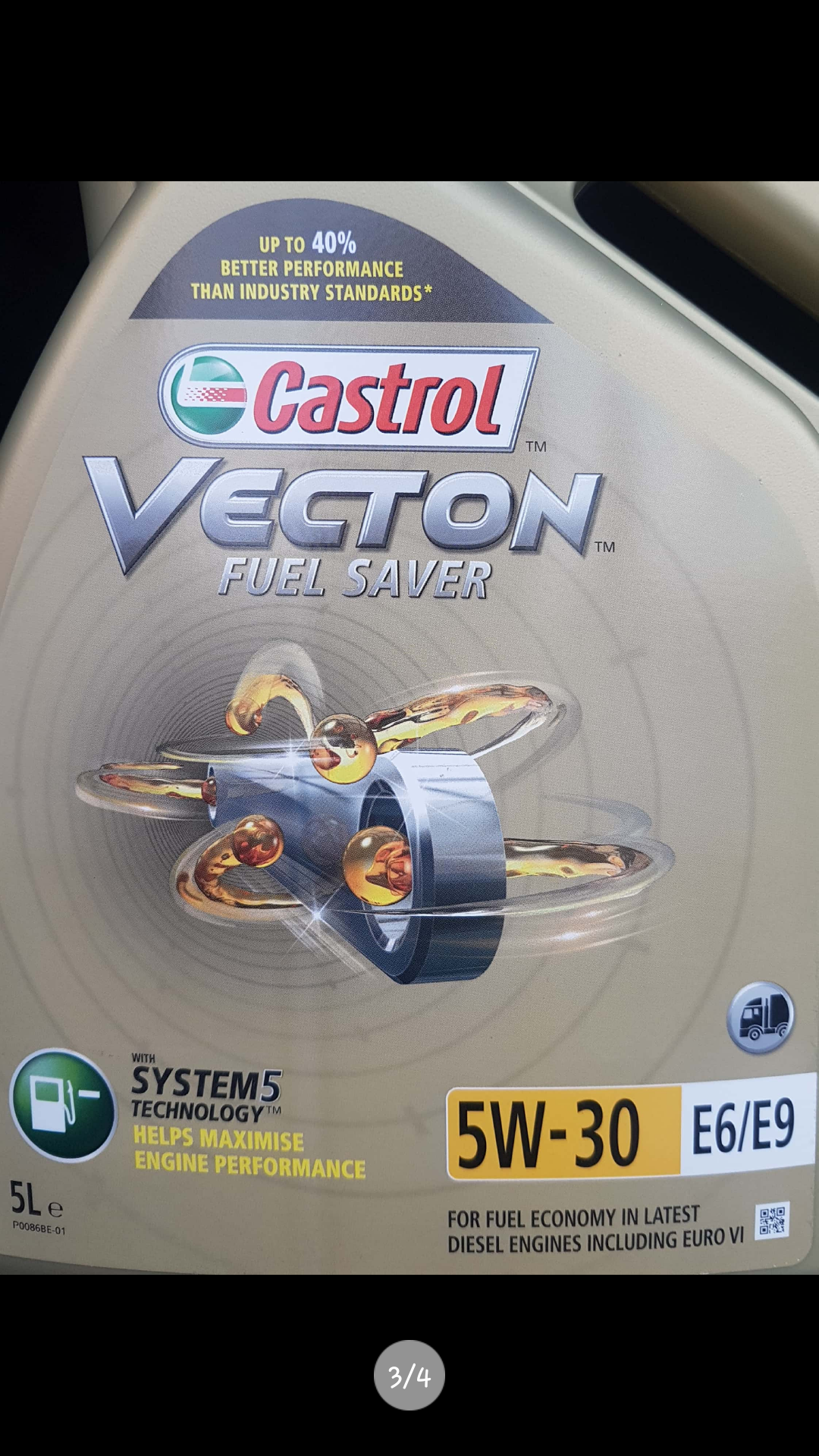

Also i'd like to ask aboyt the oil type:
I want to change oil type to castrol vecton 5w-30 fuel saver e6/e9, for euro 5 engines.ย Api cj-4, acea e6/e7/e9, meets daf px euro 5 requirements.
Its full sintetik oil so of what i'v reed in here i gess you have experience whith.
Thank you vary much for any reply.
