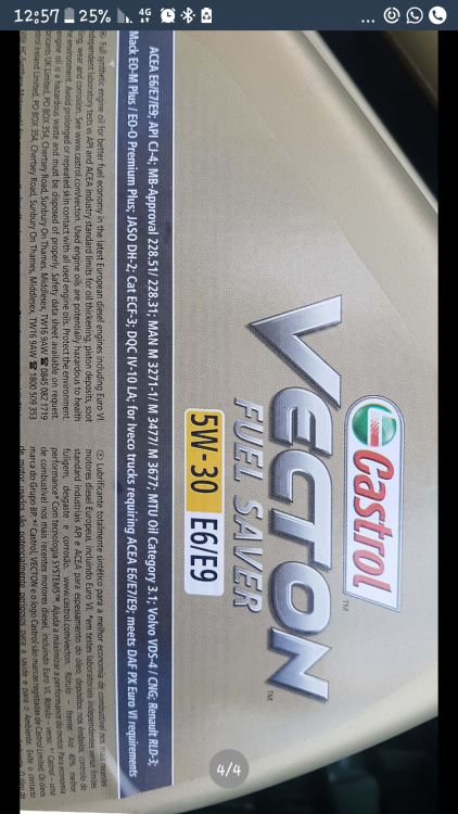

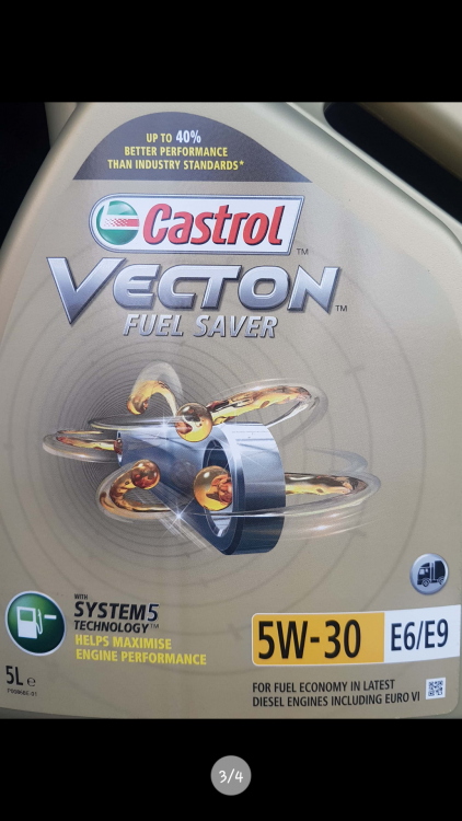

Hi,
I am expecting an expert advice on the following matter. According to the user manual of my vehicle, the recommended oil type is 5W30 approved by MB sheet 229.51. However, one of the authorized service agent in kandy suggests Mobil Delvec which is a MB228.5 approved oil.
Can this trouble the euro V engine of my vehicle.
