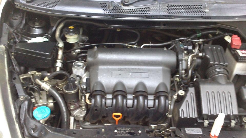

VFRhonda Posted January 23, 2013 Posted January 23, 2013 Hi All, What you guys think about running your engines at 100Km/hr for 100 km in highway without your OIL CAP ?.. Cus a service station so called them selves professionals n boasting thy doin it for 12yrs did that for my HONDA FIT .... The place is called P/yaS@n& Service n clean park located in Labudoowa , Karapitiya...Galle .The buggers had their all service bays on CCTV but when i asked for a review .,guess what they did..... they had changed all dates n scrambled every recordings n said it it impossible to play back it now....Those who love their rides should never ever step in their place for services. Quote
