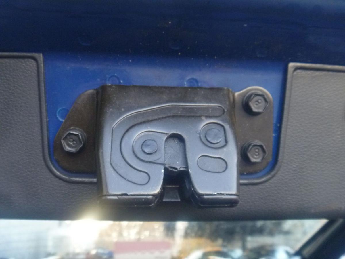

My SUV (Sportage 2011) started giving a little noise from the backside and took her to agents as she Is still under warranty. They wanted me to leave the vehicle and collect when the issue is fixed. I got a call in the afternoon to say the issue is fixed. Unfortunately the issue remained unfixed. They had fixed something else.
I had to stay there the rest of whole day and finally they diagnosed the issue to be the lock of boot door. They said the lock is not properly fixed at the factory and adjusted the lock by 2mm from the original position and said fine. It was true for about a week and again I get the same noise.
Do you guys know anybody specialized in KIA to check and fix my issue?

Apply some rounds of Paper sellotape to your back door...(to that metal part where it get locked) and see if the sounds comes...since you heard the sound lately it may not be a factory fault...just a wasted lock....check for loosen bolts also..

I too get this sound from my Sportage. I suspected its the lock and was going to point it out when I put her in for the next service in about a month. In the mean time I will try the paper cellotape fix. @DVT is the sound somewhat similar to the sound you get from Old Hiace vans? Sort of a kich kich sound?
Tried.........
Currently am running like that ........... but still there is a little noise ( not louder as before) . Somebody checked and said it's coming from the boot door beading. Not sure because the wrapping was too thick and I removed most of them and checked. Then again the previous noise started to come.......... :speechless-smiley-004:

Ah sounds like our bumpy roads are taking it's toll on the door locks and beadings. I think the problem is the lock has a little bit of play because it has to take into consideration the fact the door is shut against the beading and since its made out of rubber its going to move a bit. The whole body of the car flexes a little bit as well when you drive over pot holes.
Usually the movements are cushioned out by the beading but it seems it has proven a little too much for the door locks which might have suffered a bit of premature wear thanks to being knocked against the latch as the car moves. If the lock has already been adjusted, you can try moving the beading up a bit putting some material like bit of rubber on the metal seam and then putting the beading on top so it sits prouder against the door pushing it out. You should also lubricate the lock well.
But since its under warranty the agents should really sort it out.

Made a visit to the agents as planned
Problem solved it seems.
Certain rubber bushes were not properly adjusted and as a result extra pressure on the lock as well as beading . The guy who took over the job knew what he was doing. :sleeping-smiley-001:
Hopefully the fix will last for long.
