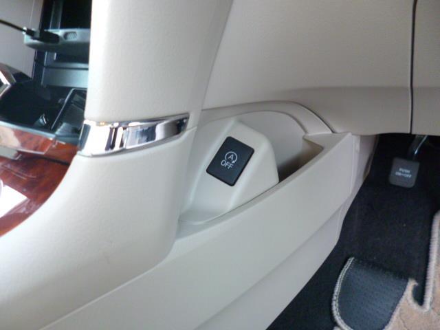

Davy Posted March 6, 2018 Share Posted March 6, 2018 On cars where this can be turned off, you will see a button with an "A" encircled by an arrow. The button should be located close to your steering wheel on the dashboard. Quote Link to comment Share on other sites More sharing options...
iRage Posted March 6, 2018 Share Posted March 6, 2018 According to the user manual it is on the side of the center console (user manual page 214)... Quote Link to comment Share on other sites More sharing options...
