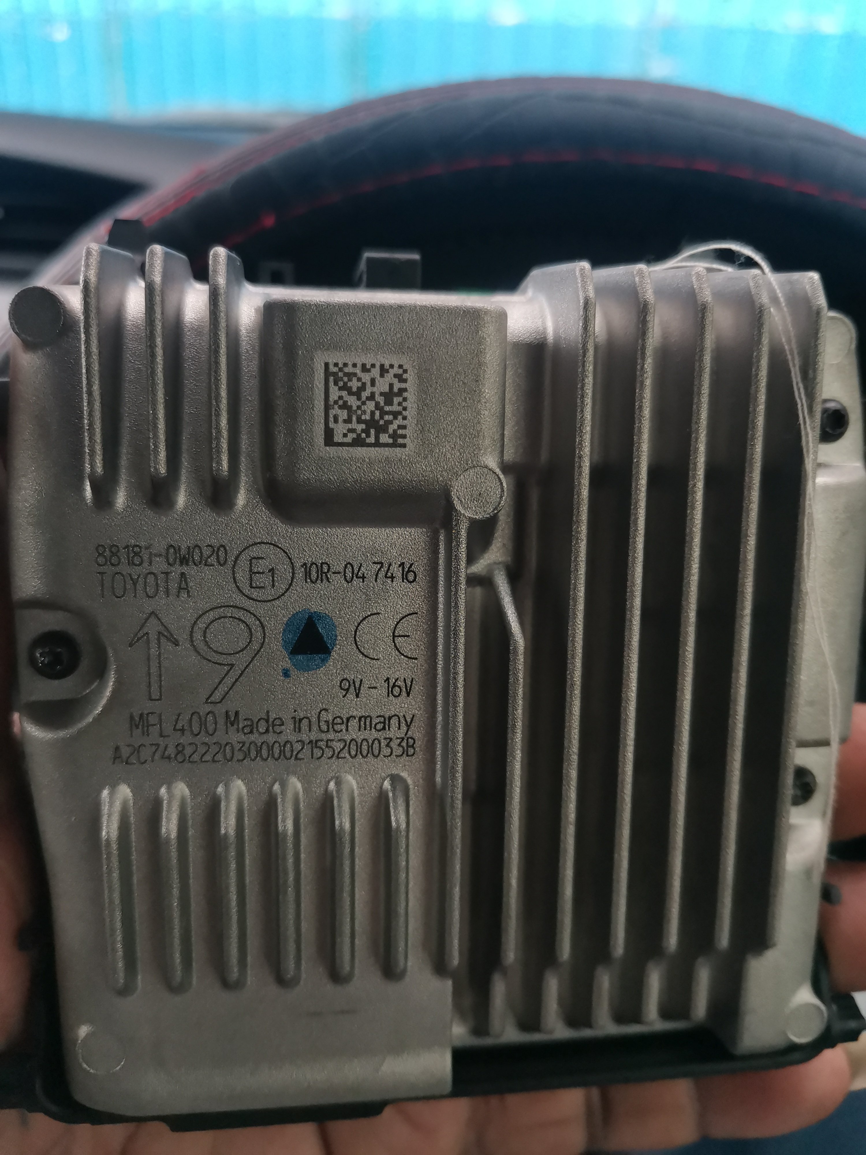

imesh yasantha Posted December 11, 2021 Share Posted December 11, 2021 Dears, I have 2015 axio safety package car and it pops up error pre crash collission error and head lamp system error messages. At that time safety system does not work. As well the camera unit on the middle top of the windscreen comes so warm and then error is pop ups. I try to replace the camera unit but could not find in sri lanka. As well I met the ejant, scan and off the error but again pops up. Pls help me what am I do next Quote Link to comment Share on other sites More sharing options...
iRage Posted December 11, 2021 Share Posted December 11, 2021 Oh dear... If you are confident (after multiple opinions and proper testing) that that is the part that needs replacing (88181-0w020 that you are holding in your hand);then the only way out is for you to replace it. Sadly, a new part is quite expensive (100,000yen...). you could check with some used car part importers and see if they can get one for you (in Japan used ones seem to range from 30-50% of the price of a new part). It is a part that is common to many vehicle models so it should not be too difficult to find a usd part in Japan for these guys. Quote Link to comment Share on other sites More sharing options...
