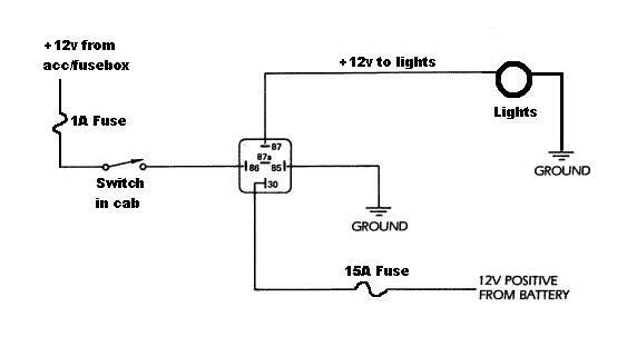

As I said before, wire it through a relay. The relay is connected to +12v (using high tension lead with inline fuse). The trigger for the relay can be any ACC signal (cig lighter, head unit) circuit. You should find the corresponding fuse in the fuse box and use a fuse tap to wire up the line to the relay.
Here's an example:
images?q=tbn:ANd9GcQ7VuX_8AqOTMtdybeZP5V
The circle marked "Lights" will be your amplifier. If your head unit already has an amplifier trigger line (corresponds to the switch in the diagram), you can use that. Otherwise you will have to go with the fuse tap on the fuse box. The example here uses a 5 pin relay with a 87a pin which is unused. The fuse ratings in the figure are indicative only.
