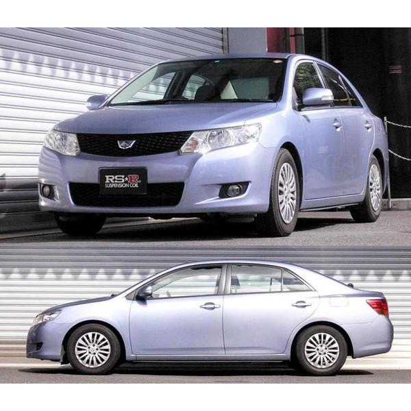

Just saying...Related imageRelated imagektspartsshop_t302d-qq-e-409_1p1.jpg?ct=02ae8a61ced7crsm0000000000.jpg
I do have the same setup.To be honest it’s very bumpy on the road.I’m looking for oem springs.From where i can buy the originals?
If it is bumpy then its because the spring rate is too high. You need to get a lower spring rate and maybe even progressive springs. If your car is lowered what type of shocks do you use ? If properly lowered you should have short stroke shocks. If you do have short stroke shocks, then putting on stock springs will not work (shocks will be constantly engaged and will not compress and decompress that much) as you would need standard shock absorbers. If you have standard shock absorbers...well..it goes to explain why your ride is bumpy (the shocks are always compressed because the strut is pulling it down so nothing gets absorbed). All this is solved with coil overs ;)

It came with these yellow springs.About 1 inch     lowered with normal shocks.I could live with it but since i replaced the shocks with kyb Now it’s too bumpy.
It does not matter if the shocks are KYB or Toyota replacements...if the shocks are standard and the coils are lowering..then it will not work. Irrespective of whatever brand you need short stroke shocks.
