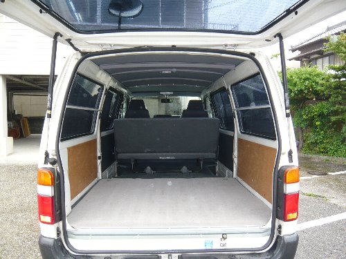

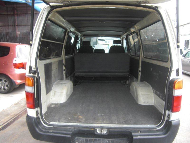

Normal vans have a wheel well sticking out on the cargo area floor (Pic 1). Just low vans do not have that and the floor is completely flat (Pic 2).
The lack of wheel wells sticking out on the floor gives it more storage space. It is achieved by lifting the rear cargo floor slightly higher and and depending on the model the rear might have two small tires on each side. In Sri Lanka people dislike it and say it costs too much to run because the smaller wheels meant slightly faster wear on the tires. Also, it means that one has to replace 4 tires in the back instead of just two. As a result the Just Low prices have a lower market value. Some have bought these vehicles for their low price and have done all kinds of things to fit a normal size tire in the back...thus the vehicle just has a wierd level in the back.

Vans that are designed to transport goods instead of passengers are the ones called "justlow" variants. Those have a flat rear floor in order to make loading and transporting stuff easy... rear wheels tend to be smaller, rear ride height would be higher,rear suspension would be different so the ride is relatively less comfortable and the bodyroll is more pronounced than the passenger variant (some say they can identify which is which after a quick drive even if its modified to look like a normal variant like @irage said.)

I just checked...the just low and the other do have different model numbers. So you can find it out that way....but then you would not need that would you ? Because at the end of the day even if the tires have been changed and suspension changed the hump is there or not there....would anyone go to the extent of actually putting in wheel well humps in there ? (assuming the vehicle has not been bud with a donor vehicle after an accident or something)
