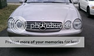

Dear all
Please, let me know a good place where I can get a cracked buffer and a dent repaired to its original state. I have a another problem, is it possible to replace taillight plastic cover without replacing the whole thing.

Tail lights: The entire assembly needs to be replaced.
Buffer: Any decent fiberglass place can repair it for you
Dent: Is it on the sheet metal and is there a crease in it? for slight dents there is a little trick. Heat up the area and put some ice on it right away. Works only on small dents without a crease though. If not you can get it repaired by any decent painter. Just make sure he pops the dent out instead of completely filling it with catalloy paste.
