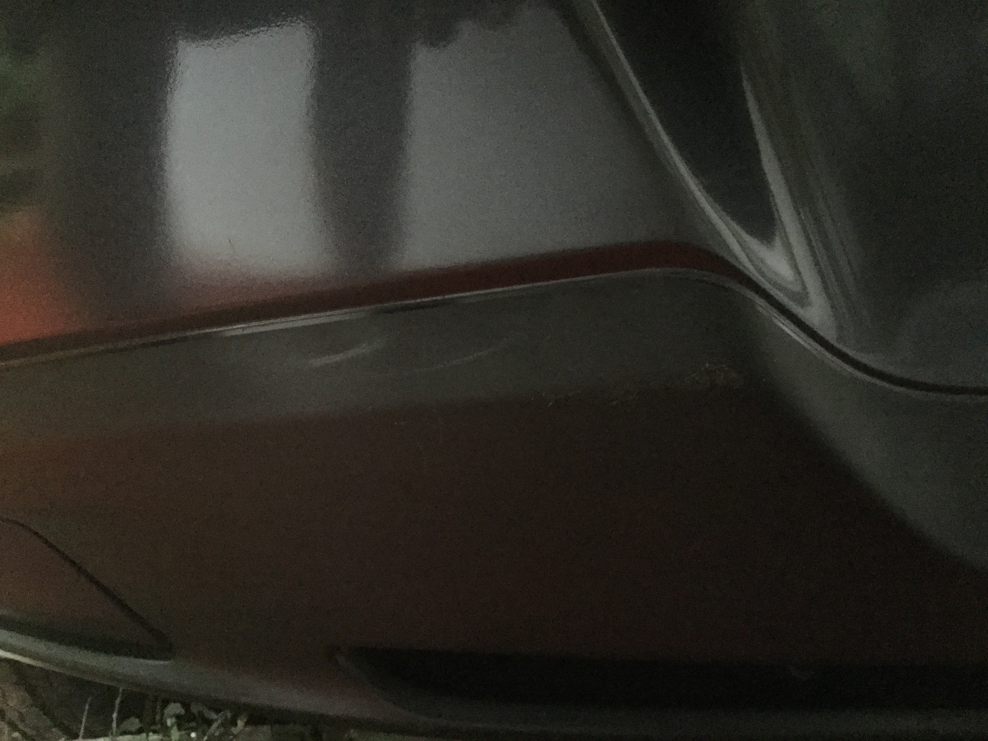

Guys, there are some minor scratches around the rear buffer area of my demio. Wondering how to remove those. I heard wet sanding would help. Appreciate if could give me some advice
The pic is not clear, give it a try with toothpaste, if it doesnt work, step up wd40-> brasso -> Rubbing compund (Autogylm / supercut)-> 2000 grit paper.
by the looks of it , its a gloss black surface with a scuff on the clear coat, does the mark disappear when you pour a bit of water?
Anyhow try one of the above, sure to buff off

Isn't that the unpainted black plastic trim under the rear bumper? If yes, you can use a good plastic polish and trim detailer.

Hi tiv thanks.I actually tried it with toothpaste.Seems it did the trick for the most part. But there are some which I believe have penetrated deeper.btw it is not the paint but the lower hard plastic part of the rear buffer.
Posted (edited)
Hi Davy. Correct.will try that..?
