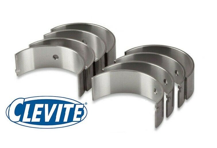

For future viewers, someday a mechanic might show you these
and the new ones look like these
before you tell the mechanic to wrap it up and sell the car, or before you start building. Realize thatย 1 of many causes would be the wrong typeย of oilย Period.
