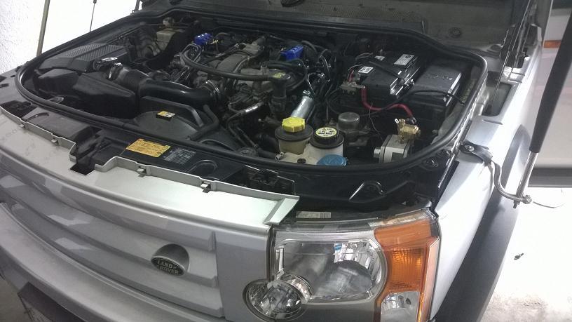

Raj1965 Posted September 5, 2014 Posted September 5, 2014 Thank to EGI i managed to install this fully computerized system to my Discovery 3 Jeep. Initially I was not sure about the product but after consulting the specialist of EGI and information obtained from the net, I decided to install it. Almost 8 months no issue at all. The saving is around 40% and I feel the decission is correct. 1 Quote
The Don Posted September 5, 2014 Posted September 5, 2014 Thank to EGI i managed to install this fully computerized system to my Discovery 3 Jeep. Initially I was not sure about the product but after consulting the specialist of EGI and information obtained from the net, I decided to install it.Almost 8 months no issue at all. The saving is around 40% and I feel the decission is correct. My Discovery.jpg Since you are a newbie, would you mind explaining your background please. Do you work for the company in question? Quote
kmeeg Posted September 5, 2014 Posted September 5, 2014 (edited) Thank to EGI i managed to install this fully computerized system to my Discovery 3 Jeep. Initially I was not sure about the product but after consulting the specialist of EGI and information obtained from the net, I decided to install it.Almost 8 months no issue at all. The saving is around 40% and I feel the decission is correct. My Discovery.jpg You could have plan better before buying the Discover 3 to see if you could afford to maintain it without having to do these kind of mods.. For others who are planning to do LPG conversions read articles on the internet about LPG conversions and research about what kind of problems users faced after converting.. (Not sure why i'm getting all negative articles about these conversions..) Those who are planning to buy a car plan ahead to see if it fits your budget. Not just to pay the money to purchase it. See if you can use the car after buying it which includes proper insurance + fuel expenses + maintenance cost.. Basically its same as planing your life right? KMeeg.. Edited September 5, 2014 by kmeeg Quote
The Don Posted September 5, 2014 Posted September 5, 2014 You could have plan better before buying the Discover 3 to see if you could afford to maintain it without having to do these kind of mods..For others who are planning to do LPG conversions read articles on the internet about LPG conversions and research about what kind of problems users faced after converting.. (Not sure why i'm getting all negative articles about these conversions..) Those who are planning to buy a car plan ahead to see if it fits your budget. Not just to pay the money to purchase it. See if you can use the car after buying it which includes proper insurance + fuel expenses + maintenance cost.. Basically its same as planing your life right? KMeeg.. Actually well said. Fuel efficiency is the least of your worries with a Discovery 3 Quote
Crosswind Posted September 6, 2014 Posted September 6, 2014 (edited) Thank to EGI i managed to install this fully computerized system to my Discovery 3 Jeep. Initially I was not sure about the product but after consulting the specialist of EGI and information obtained from the net, I decided to install it.Almost 8 months no issue at all. The saving is around 40% and I feel the decission is correct. My Discovery.jpg You could have plan better before buying the Discover 3 to see if you could afford to maintain it without having to do these kind of mods..For others who are planning to do LPG conversions read articles on the internet about LPG conversions and research about what kind of problems users faced after converting.. (Not sure why i'm getting all negative articles about these conversions..) Those who are planning to buy a car plan ahead to see if it fits your budget. Not just to pay the money to purchase it. See if you can use the car after buying it which includes proper insurance + fuel expenses + maintenance cost.. Basically its same as planing your life right? KMeeg.. Well... someone has money to buy a Discovery but has no money to pay for fuel... so this person does a EGI whatnot conversion and creates an account in Autolanka just to praise the so-called conversion. Not suspicious at all! Edited September 6, 2014 by Crosswind 2 Quote
