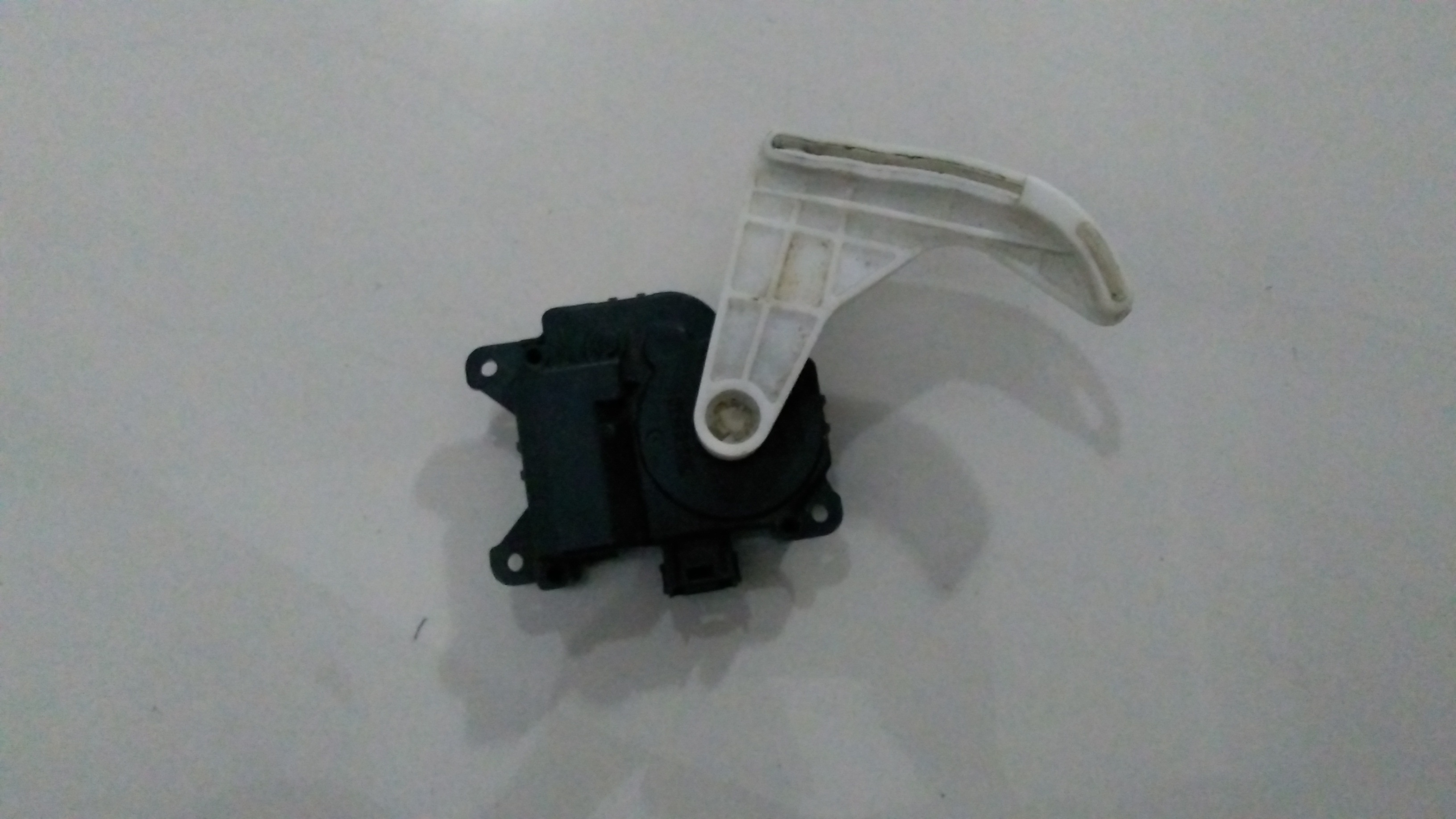

As I told before the noise is there only in the early morning. When I checked it seemed to be coming from the motor that drives the temp. control. (marked 1) but before I could confirm it disappeared. I was not able to locate the fresh/recirc flap as you mentioned. The other motor is the mode selector (marked 2). VIkarll, which one did you replace, and if you don't mind where? Im sure I have the same issue you had anyway the noise is there when ignition is on even with A/C off.

Yes, I did. I am not sure whether it is one and the same problem you have. In my case, the noise came from the motorized  fresh/ recycled air channel selector unit.
It is located a few inches above the park-break paddle, flush mounted with only one Phillips screw; not anywhere near one would perceive the sound to come from. Removing the DB or any paneling is absolutely uncalled for.
It is More or less a DIY job, and cost me only about Rs. 2000 for a re-con unit, an year ago.

It is your label 1.
Sorry, my year old memory has not served me right. Looks like it has not one but 2 screws.
I have attached two photos for re-confirmation.
Suggest you remove the wire harness first and monitor for a few days to see whether the sound goes off.
Good luck this time !!!
Edited by ViKARLL
  • 0
Thanks. But strangely as the sound appeared, it is gone now. I only once for a second had a chance to peek under the DB and I am sure this is the culprit. So it is the temp. controller. ( Fresh/Recirc flap is above the cabby on the passenger side)
