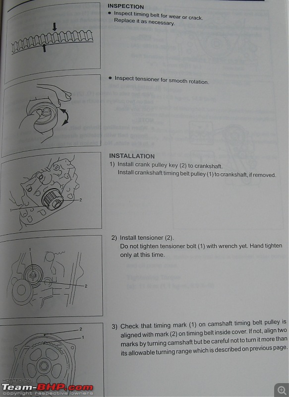

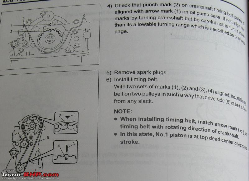

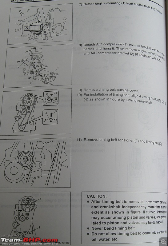

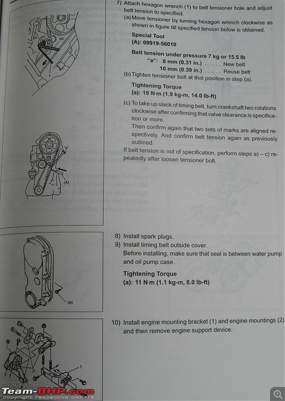

I think for doing inspection we have to remove the engine, right? Do you know a way to check the condition without removing the engine?
No Not. You dont need to remove the engine to change the timing belt. See following images. Changing the timing belt is not a big job / big repair. Dont fear about it.

Thank you Kusumsiri for sharing this.
