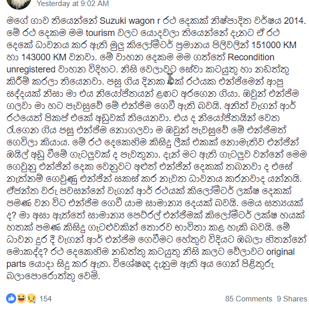

Speaking of Wagon R.... I saw this on FB now the validity of the claim is subjective BUT since we spoke about long-term usage of Wagon R and Keis in general posting this here.

This could be due to his personal issue of maintaining.
WagonR needs both engine and hybrid battery serviced on different intervals. If battery is ignored, it lacks the power given to the engine or whatever the power that it gives to move the vehicle. So the engine gets overloaded and it runs out quickly. Also, with heavy luggage will make this worse.  Tourism means heavy luggage and at least considerable no of people.
There are known facts (off label) being practiced by some service agents to keep domestic cars in operation to our road conditions and climate. (Unreg,Recon means these units have been used in Japan and who knows what happened there) Even though we service according to the manufacturer, "Where was the service done?" is a question.
I believe, a well maintained Wagon R can be used more than 150000kms and as it's a hybrid with very little engine, it needs more care than other cars.

We had 2 Susuki alto -2 and Suzuki 800 and charade they all had the came issue after 150000 Km 660 - 1000cc cars.
They stated puffing blue smoke so we sold them quick.
the new engines have start stop as well and some are turbos so the engine has do a lot more.
