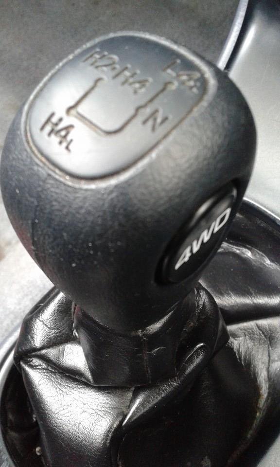

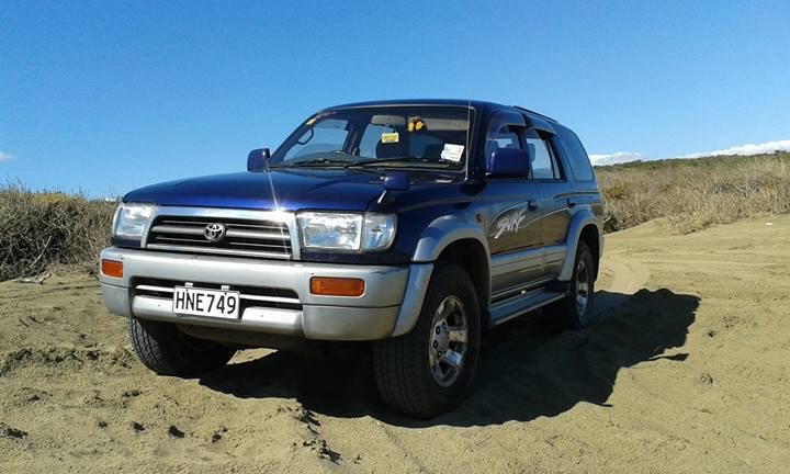

This is my actual truck prior to mods and the gear stick of my truck
This particular truck is SSR-X Limitedย trim. I wasn't aware lockable diff was an option attached with the trim level

The locakable diff was assorciated with the 4WD system (Multi-mode 4WD) whic was associated with trim and engine variant.ย
The SSR-X got the diff lock only in the diesel variant. The petrol SSR-Xs came without it. Then the SSR-X Limited was a special spec car (kind of like Axio X Limited, RAV4 C Limited, G Limited, etc..). It took the SSR-X and mixed a bit of the SSR-G features in to it.ย  The multi-mode system became standard on all grades with the facelift.
Yes..SSR-Vs are hard to find and so are the narrow body variants. Most of the narrow body variants andย in Japan I have seen were highway repair vehicles or cop cars.ย

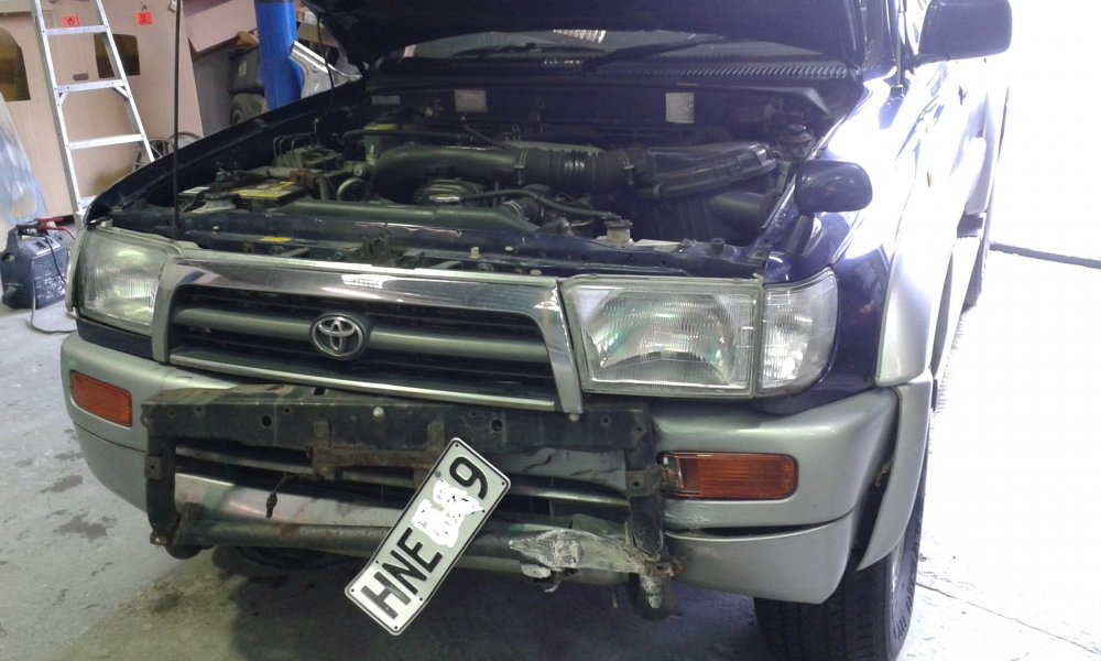

Mine actually came with front nudge bar but i have crashed into a concrete fence soon after purchase the truck, so it was a bit expensive to find and later I have replaced the front bumper with MCC bull bar.
If I am not mistaken mine is Outdoor Sport or something, came with Toyota Conlight, adjustable shocks (soft, normal, hard) guess this is a Limited feature from SSR-G and rare view mirror mounted compass unit.
