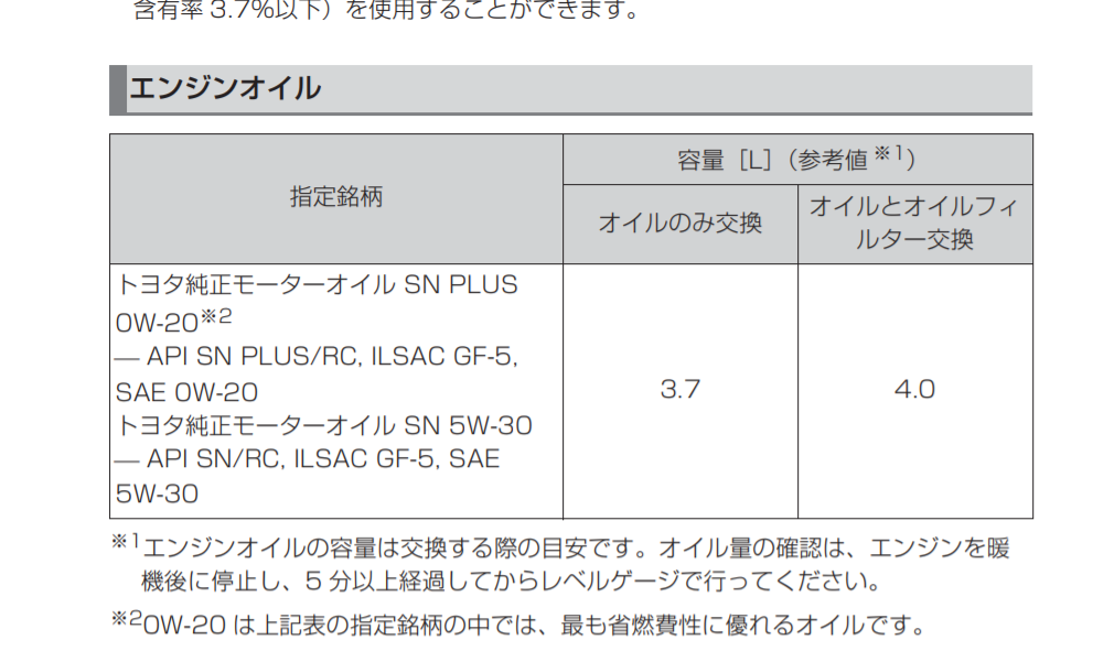

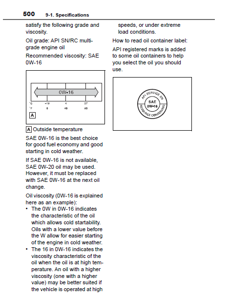

Here is the owner manual for the Corolla Sport.....for a 1.2T. The recommended oils are 0W-20 or 5W-30...and it says 0W-20 is what the car comes with from the factory and is recommended for the highest fuel efficiency. There is a whole paragraph about how maintenance should be carried out by the nearest Toyota Dealer who will advice you on parts and services that your specific car requires. Now do not forget..this works for Japan where the car does not get used that much and even if it does..the traffic in 99% of the areas are a lot better than in Sri Lanka. Also..the Japanese maintenance manual does not have a lot of things that manuals of export models have (because a lot of them get covered under mandatory maintenance work for road worthy certifications)

Haven't we said it right at the beginning that the manufacturer's manual itself says thinner oils are recommended purely for fuel efficiency ? and the context is based on normal use ? Did we also not say that although thinner oils would increase fuel efficiency...using it in situations like in heavy traffic (like 95% of the ime in Colombo) would reduce engine longevity because the engine oil would thin out and lose its lubricating properties (thus showing signs of higher knocks from the engine) ?
So it is up to the owner to decide if the savings from the slight fuel efficiencies gained by thinner oil outweighs the cost of wear the car would under go as a result of thinner oils. For a new car being the first owner and planning to use it for 2 years might not make a difference..but the longer you keep it..the more significant the effect will be (don't forget...lesser lubrication means more wear on the engine components which implies lower fuel economy)
