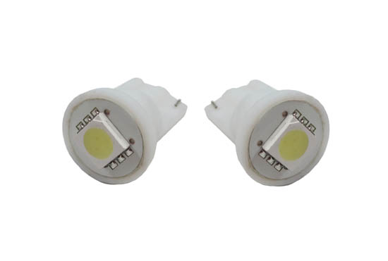

Thanks machang, dark spots are due to two reasons
1. There are only 4 bulbs to illuminate the entire area..
2. The LED type i used was T10 with 1 SMD (See Fig 001) which only focus the light in to one area... Ideally i should have used LEDs with 5SMDs (See Fig 002) so that light is evenly spread throughout the entire gauge cluster.. (I have ordered them already)
Fig 001
Fig 002
  On 3/13/2015 at 6:20 AM, Sierra Charlie said:
Trinity, Good job machan. I've put them LEDs on my dashboard as well. Mighty convenient having those. Any idea how to get rid of those dark spots?
Thanks machang,,,
1. use LEDs with 5SMDs (If possible)
2. Clean the plastic that helps the light to travel all around the panel.
  On 3/13/2015 at 8:04 AM, Davy said:
Had a good laugh reading the chat. Yeah, good job trinity.
You will be able to get rid of the dark spots if a bulb with 5 SMDs is used I guess (one SMD pointing at each direction).
Thanks Davy for everything,,, I ordered LEDs with 5SMDs.. will put them and see how it goes once i receive them..
