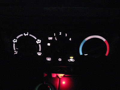

Chathurike Posted January 22, 2014 Posted January 22, 2014 does any one know a place to buy these kind of white colour bulbs for lancer?? or in Ebay ?? Quote
vidura Posted January 22, 2014 Posted January 22, 2014 does any one know a place to buy these kind of white colour bulbs for lancer?? or in Ebay ?? no idea about local place but in ebay u can find those bulbs. those are T5 type bulbs. I also ordered some and waiting for them http://www.ebay.com/itm/230696520962?ssPageName=STRK:MEWNX:IT&_trksid=p3984.m1439.l2649 hope them will fit to my dashboard Quote
Chathurike Posted January 22, 2014 Posted January 22, 2014 no idea about local place but in ebay u can find those bulbs. those are T5 type bulbs.I also ordered some and waiting for them http://www.ebay.com/itm/230696520962?ssPageName=STRK:MEWNX:IT&_trksid=p3984.m1439.l2649 hope them will fit to my dashboard thnx for the reply i have srching these bulbs from long tym bt cudnt find in Kandy. hope it will fix for your car.its a small bulb typ wch you can find only in Mitsubishis.can you give me a link to buy ignation light bulbs as well?? Quote
vidura Posted January 23, 2014 Posted January 23, 2014 thnx for the replyi have srching these bulbs from long tym bt cudnt find in Kandy. hope it will fix for your car.its a small bulb typ wch you can find only in Mitsubishis.can you give me a link to buy ignation light bulbs as well?? First you remove the existing bulb and check their socket type (T5/T4/T3) Then search it on ebay. Ebay has any type of bulb with any color so u can easily find them. You just want to sure about the socket type Quote
