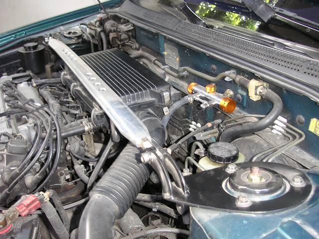

You can just get a strut brace which is the one installed in the engine bay between the shock absorber towers. The bottom flexes a lot less than thr top of the car because the existing suspension already provides more rigidity.
And no, you don't have to drill anything. You can fbolt on to your suspension mount (same top bolts on the shock absorber) .ย
images?q=tbn:ANd9GcTz_pouiT3FEqCfEdWg_hs
The mounts are not as easily accessible as in this, will need a different specialised brace
That's the Yaris GRMN with a factory strut brace (you have to look closely to see it - especially since it's black). It's just not out in the open. The strut towers are under those plastic weather shields and will have to be taken out to install the brace. But I'm pretty sure it's just a regular one-piece, non-adjustable brace under there that mounts onto the strut bolts.ย
