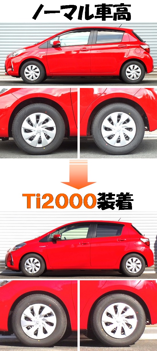

Here is some motivation:
Story is here :ย https://www.craft-web.co.jp/blogs/suzuka/17_11/
Another mod with stock like wheels on Modelista low down springs
p1.jpg?ct=f69ebe17a776
[รฃรฃยจรฃยฟ(รงยดรฆยญยฃ)] รฃยขรฃรฃยชรฃยนรฃยฟ รฃยญรฃยผรฃรฃยฆรฃยณรฃยนรฃรฃยชรฃยณรฃยฐ
Stock vs low down :ย https://minkara.carview.co.jp/userid/255681/blog/39252747/
[รฃยตรฃรฃรฃรฅยฑรฃรฃ] รฃยซรฃรฃรฆยธรฃยฟรฃยซรฃยผรฃรฃยฃรฃยซรฃย รฃยตรฃรงยปรฅ
