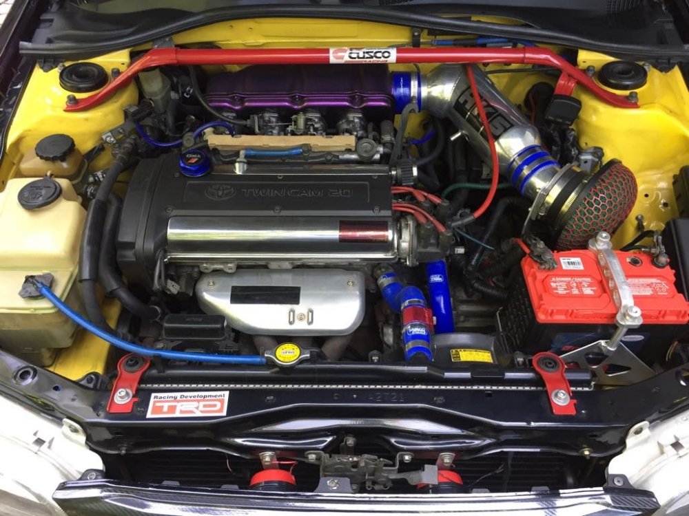

Yes with this lock down could not go and see the car. The seller has changed the engine and gearbox from his his old 4AGE with 5 forward to a new same 4AGE to a 6 forward which came from the facelift version. Here are some pictures.

Ah, this car. A nice looking thing but it has been on sale for way too long. Better inspect it throughly with a professional. I Believe the car is in kandy now?ย

8 minutes ago, kadsa98 said:
That looks like it's in all right shape.
That's how every girl looks like until you start dating them

? yes very true, she looks nice with the makeup. Yes it's in Kandy and somebody told me that it has met with an accident. Maybe dats the reason he has put a new engine and gearbox. Why would anyone swap a 4AGE with another same engine.

I see. But I have never heard of an accident so bad that the gearbox needed to be changed. Maybe something else is going on. Whatever it is, be cautious. Carina GTs in good nick aren't much around and the price on this one is also too good to be true.ย
Not discouraging you, would love to see an enthusiast like you get a nice ride, but best be careful.ย
