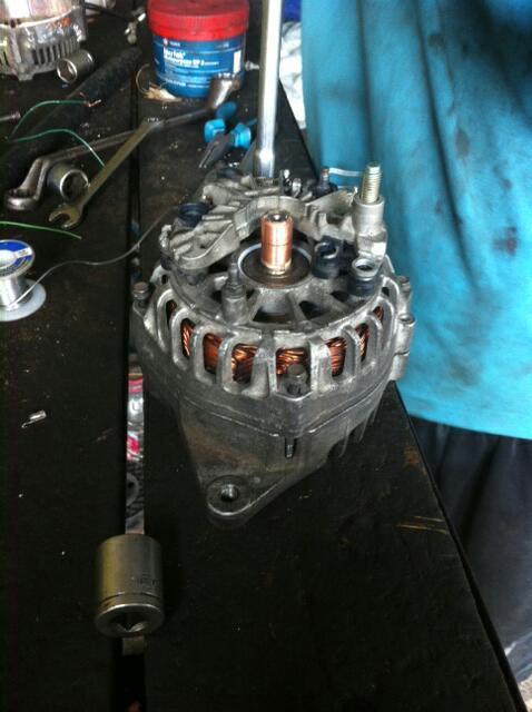

FINAL UPDATE:
I don't have any written quotation. It was just verbally given to me by the owner after consulting their workshop.
OK so today I went to Saman's place to check the defective alternator. He reconfirmed what me and my father diagnosed to be working parts.
Get this. The only parts that needed repairs are as below;
Slip rings Rps.1,000
Teflon sleeve Rps. 1,900 (this was actually broken by PALA electrician while dismantling the alternator. So obviously the part was not there when the assembled alternator was collected the next day).
Labour Rps.800
Total cost: Rps.3,700
post-8799-0-11023000-1422898747_thumb.jp
post-8799-0-82268900-1422898834_thumb.jp
post-8799-0-00419500-1422898895_thumb.jp
The alternator was bench tested by Saman and it worked fine.
Thanks to all of you guys for your support. The Don - thank you. I'll keep you informed :)
