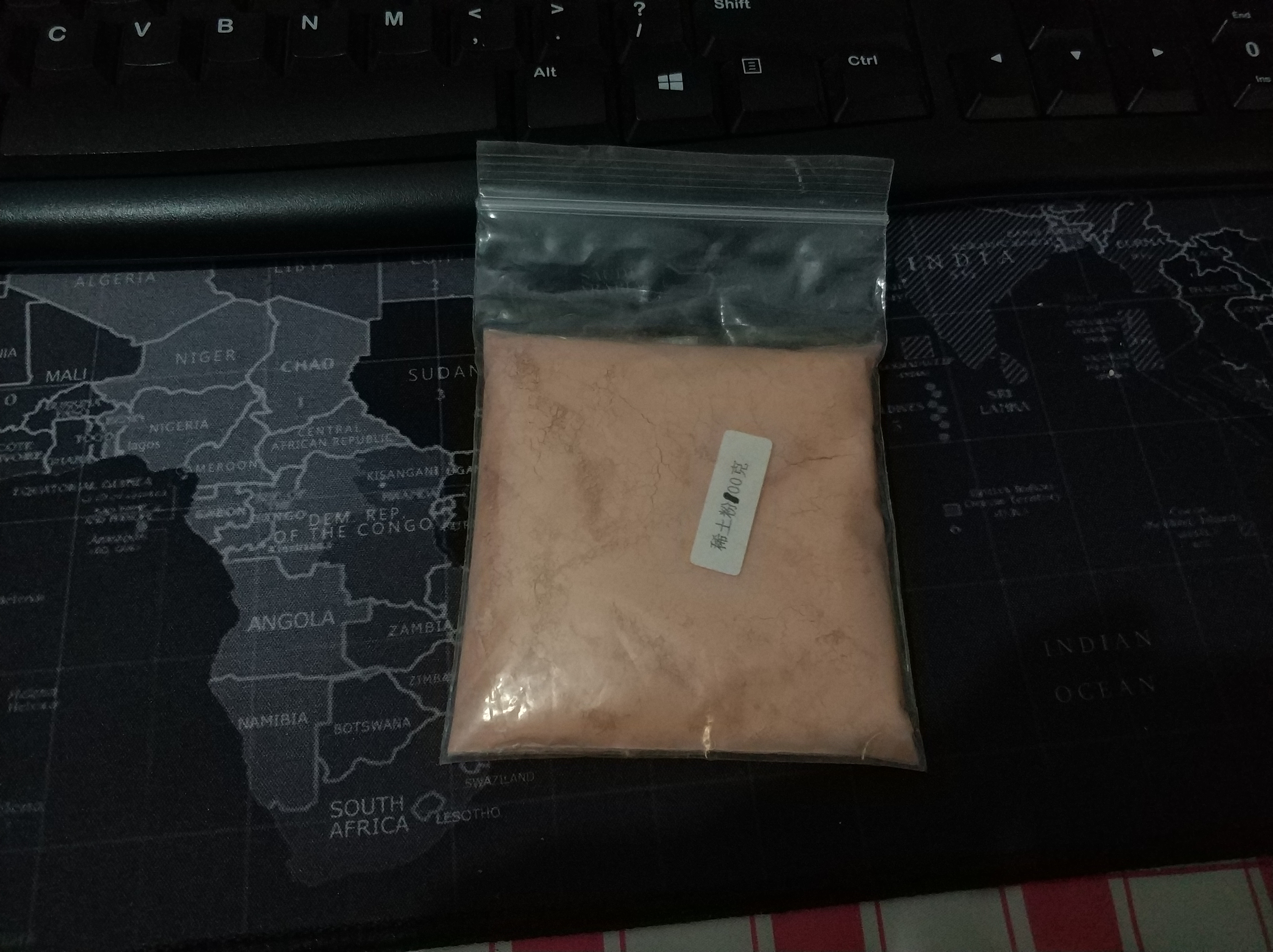

16 hours ago, Iced-T said:
Hi @Iroshw
Did they use a compound that looks like this (cerium oxide) ...Β mix with water and use a buffing tool ?
Regards,
Iced-TΒ
Not sure, they used something like Cream/Gel with the machine. Also sprayed something when using the machine. They did part by part.Β
  • 0
