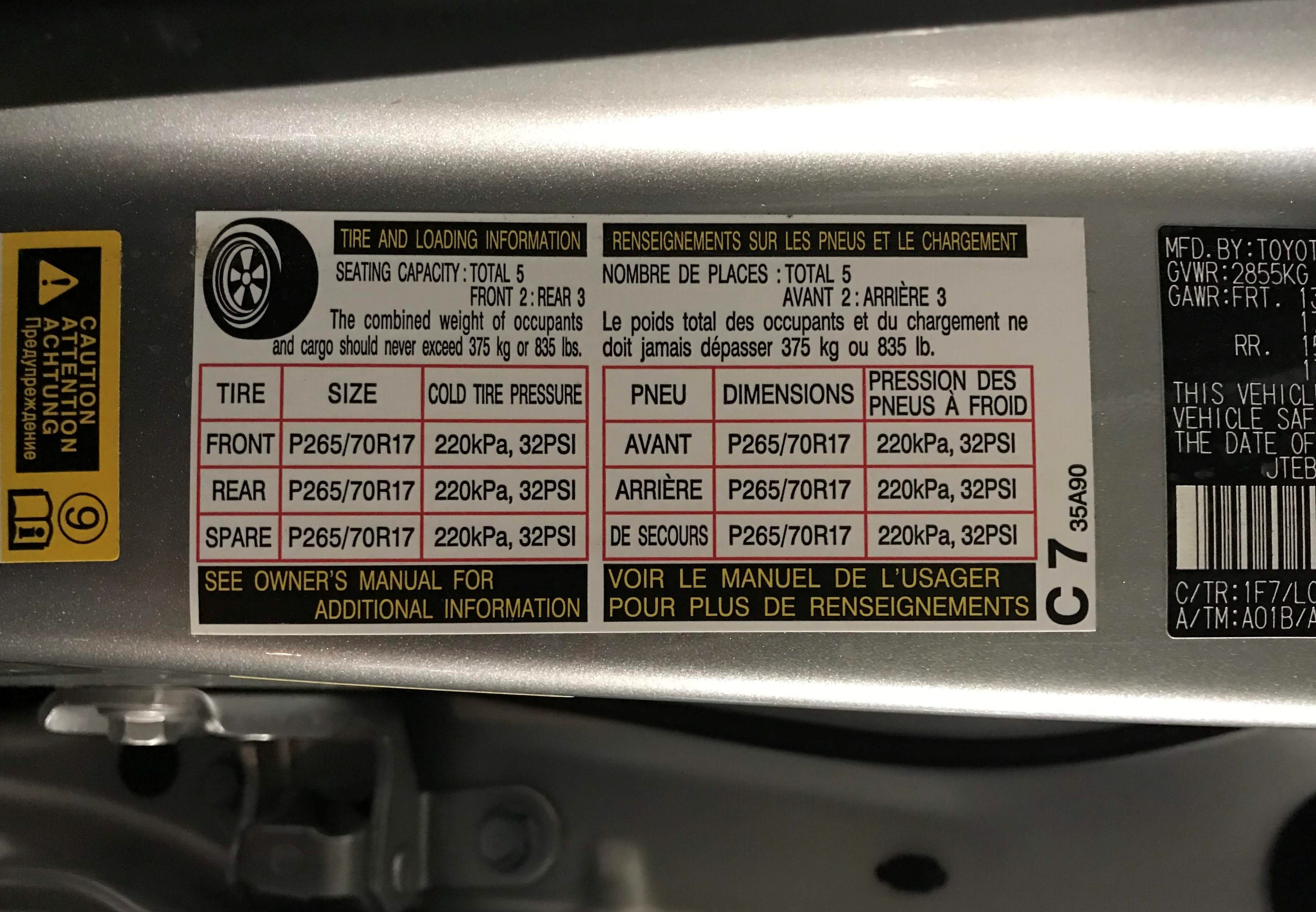

I would simply follow the info on the tire info tag on the driver side door..
This is the right thing to do. If that's the tyre pressure chart on your car, then it's obvious that they've stated equal tyre pressure all round. If you read the owner's manual, you should be able to find information on how you should maintain equal rolling diameter as well.ย

The tire sticker I posted was from a 4wd vehicle. So unless I select 4H or 4L the vehicle is powered by the rear wheels all the time. But mine says to run same tire pressure.ย I would say;
1. Simply follow what manufacturer specified.
2. I would neverย over inflate from the spec so it would effect braking distance.
3. I would neverย under inflate from the spec so I would get bad gas mileage and premature tire damage.
** The only time I would run on relatively low tire pressure is on a off-road situation where I need a bigger foot print so I wonโ€™t get stuck on sand or mud. But I try to avoid it to my best. Tires are damn expensive and I have many other expenses to think of..?
Bottom line what I want to tell was keep the tire pressure as specified by manufacturers. Not from some article on Facebook or Google. Try not to buy cars that have different tire sizes front and rear so that you can do tire rotation without any problem.
